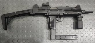

Here is my Uzi after spraying and at the start of the 5-days curing process. You can cure disassembled parts or the assembled firearm, it doesn't really matter so long as you don't scratch the air-dried, coated surfaces. 5 days from now I will oil down the Air-Cured parts inside and out, then remove the excess oil which will leave the matte black with a touch of oil sheen. Note that the Sight, Bolt, Magazines and plastic Furniture were not coated.

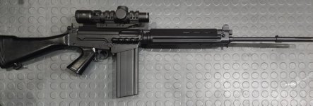

Here are the Uzi and a Browning/FN FAL Match rifle, after getting a coat of oil wiped on and off of the Matte "Glacier Black" Ceracoat applied 5 days earlier. Note how it deepens the Black colouration. Close enough to perfect for me.....
Two Thumbs-Up for CeraCoat Air-Cure products!
