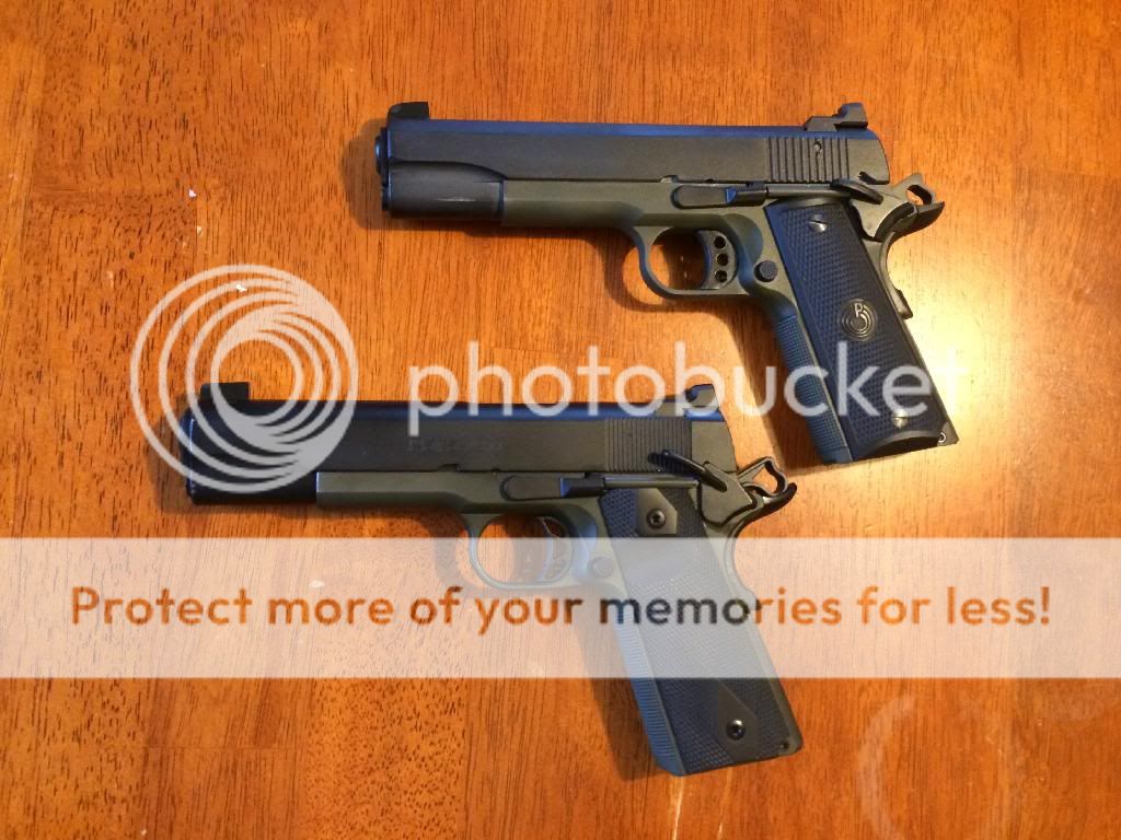

Arma Coated GSG... Took over 1000 rounds of CCI stingers before it started working with bulk ammo.... The coating is starting to wear off already :( on some parts due to the cheap pot metal used in production.
I have about 5000 rounds thru it since this picture.... I can still see my #'s no problem
I can read the serial numbers fine (upper gun in pic) but I had the air turned down a fair bit and didn't blast it any more than necessary . Pretty sure you could cut a gsg slide in half with 120 psi and aluminum oxide
I had a couple of Stainless Colts Cerakoted Black at BC Cerakote, Colt doesn't stamp the "Rampant Colt" or in 2011 the "100 Years Of Service" on the O1980RG Model that comes from the factory in Black Cerakote due to it filling in the Roll Marks
I am very pleased how they turned out, the 100 Year stampings were light and varied depth to begin with, can still see them well enough for my taste, the Serial Number and Model ect look great
