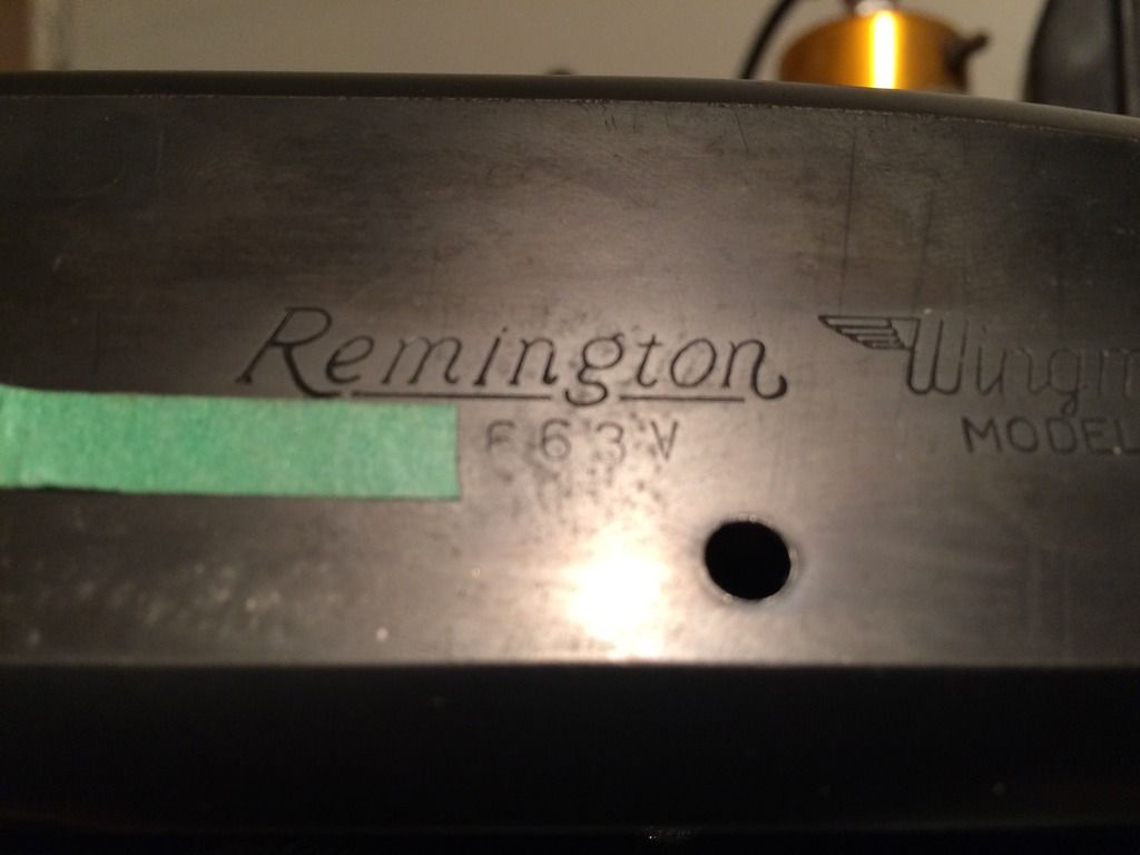

I have decided to get my wingmaster cerakoted. This is my first time getting something coated and was wondering about the effect on stampings. My serial number has a few very lightly stamped numbers and my worry is that they will disappear after the process. The bottom of the first 6 and the 3 are pretty thin at the bottom.
I have read and seen pictures showing that it isn't very thick and most marking can be seen afterward but this is not very bold lettering to start with. Should I get the numbers stamped on another part of the reciever just to be safe? After the coating I won't be able to with out chipping the cerakote.
Anyone else had this issue?
By the looks of the finish. it will need some serious sandblasting. Even though it is very fine sand, you could loose enough of the engraving to make it hard to read. Either get the numbers re engraved or stamp the receiver possibly underneath near the loading gate. If that is legal. I don't know why it wouldn't be ok.
Personally, I would have them restamped before the coating is applied. I have a Rem700 receiver that has the same issue and that is what I want done before it is coated.
