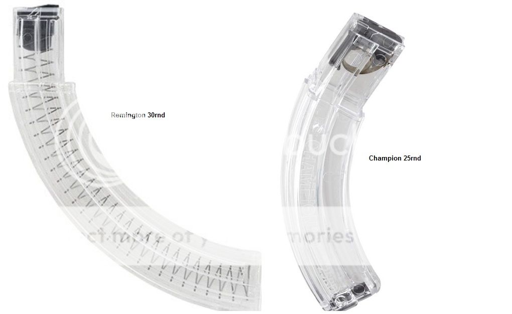

This Champion mag has a coiled up band spring vs the rectangular zig-zag spring most mags have.
let us know how thy fit-feed & how easy to load. Thanks

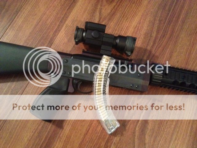

Im hoping to get out to the range soon, the only thing I have been able to test is loading he mag.
It loads incredibly well, the spring tension is the same the whole way down. #25 is as easy as #1
must be because of he spring design.
Here is a comparison of the two springs

Results
Finally got out to the range the other day but unfortunatly the mag did not perform well. It fed fine when a round was sitting in the feed lips but, almost every round got hung up and did not feed because it was not being pushed up.
The rounds I was using where blazer bulk and they where more waxy than what I normally feed my gun. I thinking the wax was gumming up the mag and not allowing it to function properly so im going to give it a cleaning and try agin with cleaner ammo.
