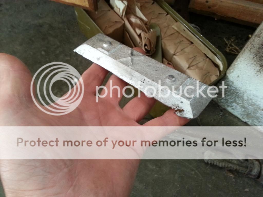

I went out to Stittsville today to pick up another Lee ingot mould to do some casting. I have one now, but when you are smelting 150 lbs or more, it heats up and takes time to cool off between pours (they break or go like playdoh when they come out). For the first time I have ever been out there, they do not have any :(.
I have read of people using muffin tins to use as cheap ingot moulds, but I have also read about some of them causing the ingots to stick. What should I be using, and what should I not?
Thanks in advance for any help I get.
