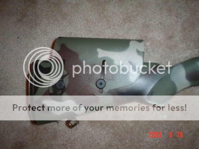

Almost every M14 type rifle I owned had a Rooster33 adjustable cheekrest (Thermo Plastic). You had to drill two holes through the stock.
The cheekrest was solid and easily adjustable.I installed over a 100 of those cheekrests and never had, or heard of any problems.............
A few examples.......These pics show the first generation cheekrest with the original style hardware.The hardware was changed to larger knurled parkerized adjustment knobs, and the front of the cheekrest was cut back to allow for more room for your hand......
The second generation cheekrest:
Third generation with the new hardware........
There are several companies making this style of cheekrest these days.........
