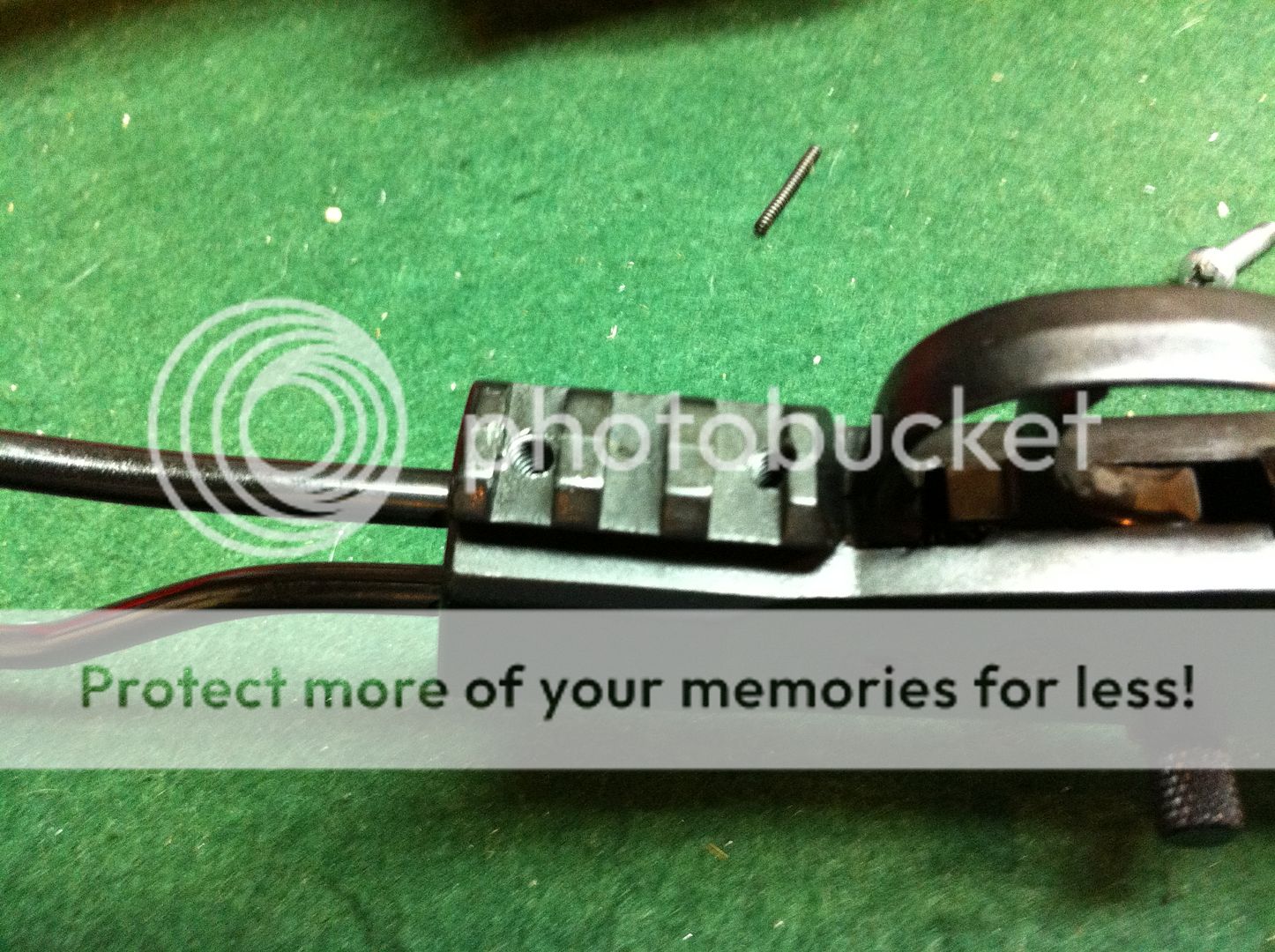

the gun has 2 threaded holes there and also a picatinny rail there as well.
in walk the problem.
no after market pistol grip i have seen yet will fit and the small chunk of picatinny rail that is there is not a standard 20mm one.

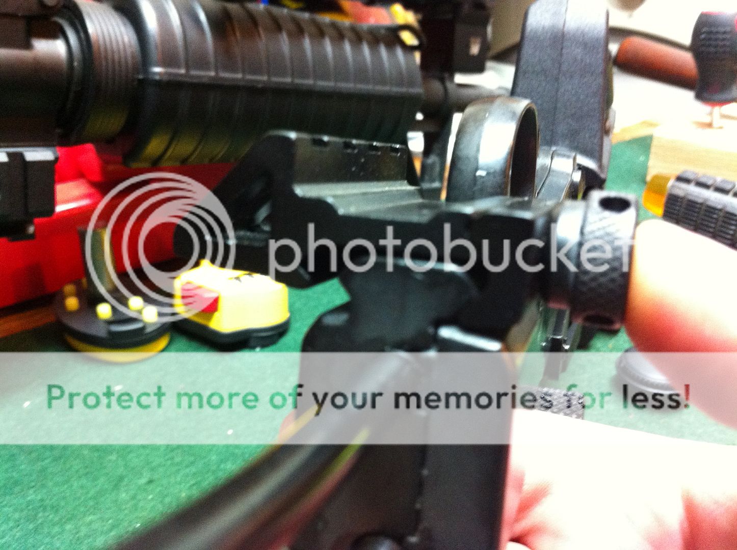

nope, mine thread in, which i thought would work but dont for 2 reasons.
1 - the little badgers threaded holes are not the same as the ARs bolts, the angle as well is wrong.
2 - the small picatinny rail chunk that is there blocks the AR pistol grip for seating.

then i noticed that the small chunk of picatinny rail on the little badger is not the normal size like the quad rails on its front.
they are in fact about 1/4 smaller in width.
say 15mm wide instead of the normal 20mm.
so then i thought id just remove the rail and put on a after market one.
nope, the rail is carved into the metal unlike the removable ones on the forgrip.

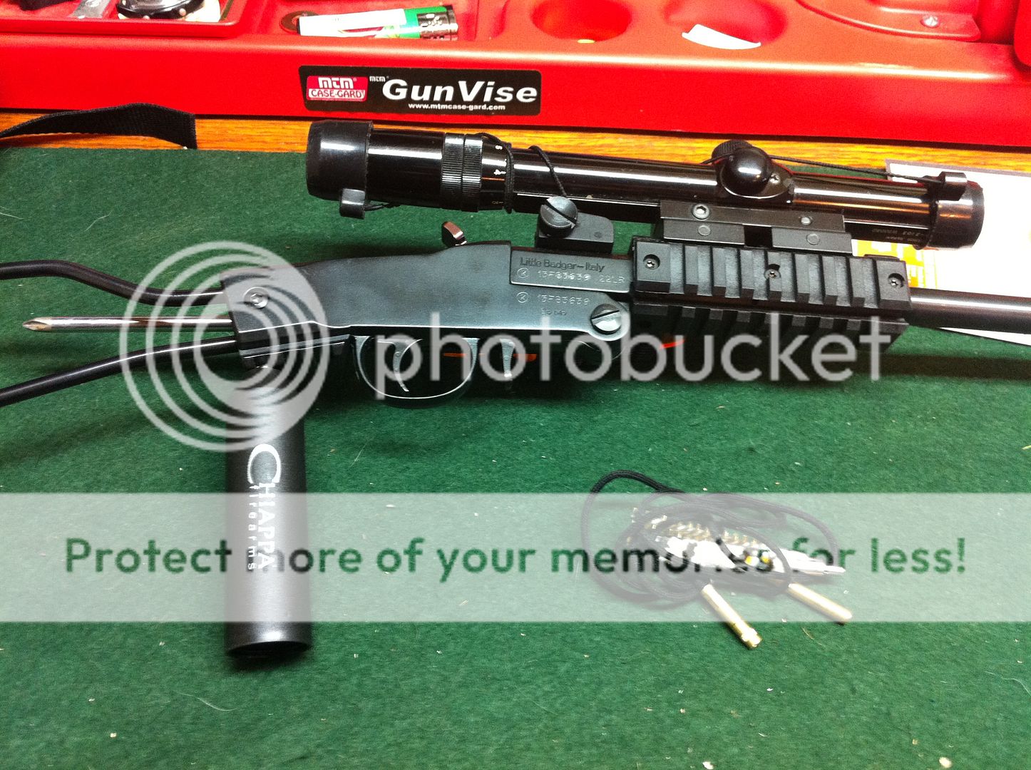

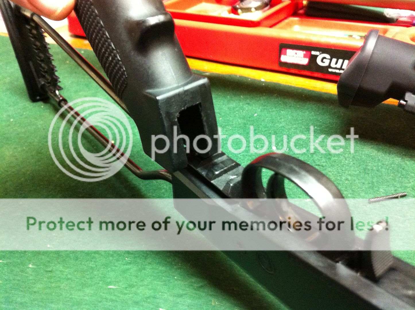

the cheap ####ty chiappa pistol grip
the rail / holes behind the trigger

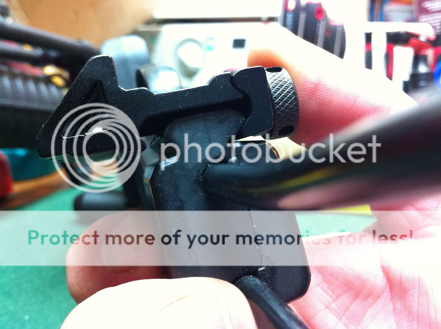

holding a AR pistol grip up to the rail, you can see how the AR gap is a lot smaller then the rails width is
here is the rail on the underside, im holding a 45' offset rail on it so you can see how it dosnt fit on it (was the smallest thing i had handy to show with)

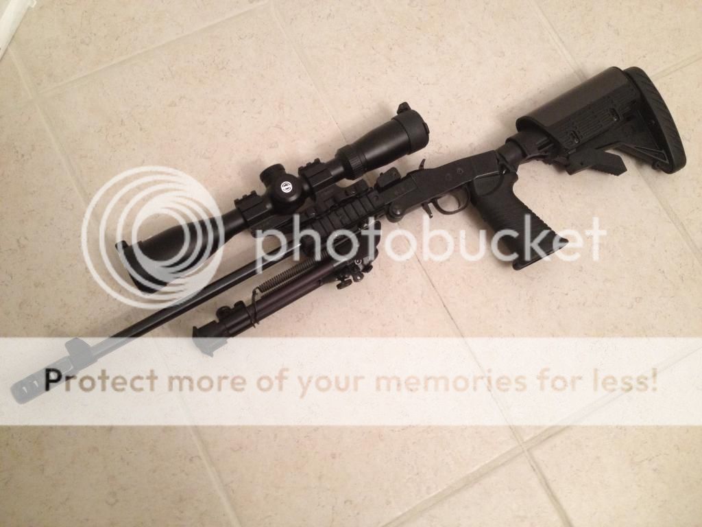

I have filed both an AR grip (not shown) and a tapco grip (see pic) and both have worked quite well.
I only assembled this as a joke, but I actually kind of like it... I find it very comical.
I would probably take the original Chiappa pistol grip they sent you and fill it with epoxy or contact cement or something and let it harden. would that make it rigid enough to be functional?
