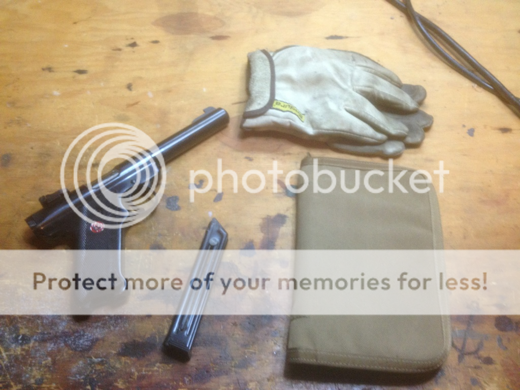

When I was in high school one of my buddies bought one of those sweet little Ruger .22 semiautos. I would have loved one myself but most of my money got spent pouring gasoline down the gullet of my gas gobbling hot rod at the time. I eventually bought a .22 pistol but opted for the Ruger Single Six. I didn't regret it and as a matter of fact...I still have it and still love it. I am estimating that over 30 decades I have put around 20~30 thousand rounds through it...and it might be time to start thinking of a .22 to take me through my golden years. I was watching the retired old hands shooting the other day and they are all running the Ruger semiautos that I loved as a kid...and decided to buy one.
The new Mk. III's aren't like the old school guns at all. They have a loaded chamber indicator that I absolutely loathe...but they have an honest mag dump now too. Plus they come with scope mounts - right in the box! It is my scholarly opinion that the battle for the most handsome pistol in the world will be a tie between the Luger and the Colt Peacemaker...and the lines of the little Ruger evoke those of the Luger to my eye. This is a nice looking little gun! The target sights don't get much better than this either.
The only serious gripe I have about this little sweetheart is the trigger - it's about as smooth as 8 miles of oil lease road! In a way that could be a good thing for the beginner because it forces you to think your way through the shot and really concentrate on your follow through...but it slows me down and I prefer to get a shot off in the standard 8 seconds or less. Can any of you fellas recommend a good smith for these guns in Alberta? I thought Volquartson was making trigger groups for them too at one time - do any of you have one so equipped?
All I need now to properly enjoy this little gun is three cases of practice ammo and an early retirement to enjoy it!:)
