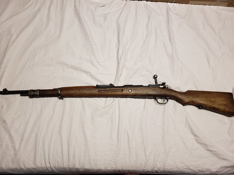

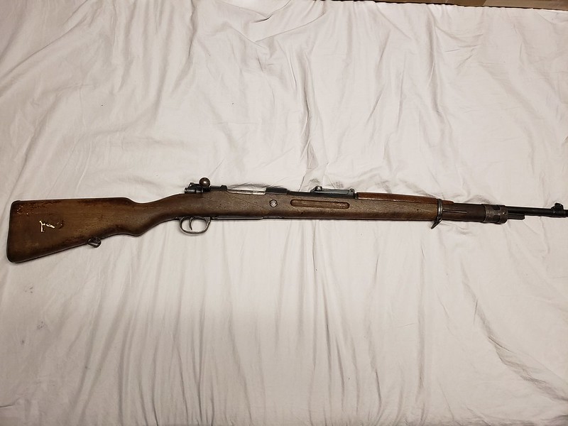

Awhile ago I got a Chinese mauser at an auction. I didn’t know much about Chinese Mausers and information seems a bit sparse. So any information on this rifle would be greatly appreciated. My plan was to use it as a project build but I figured I should learn more about it and if it has any value to someone’s collection before I alter it in some way.
It appears to be a chiang shek mauser which is based on the mauser standardmodell

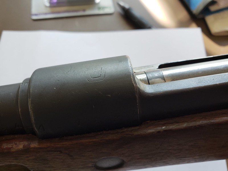

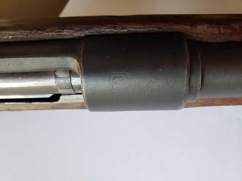

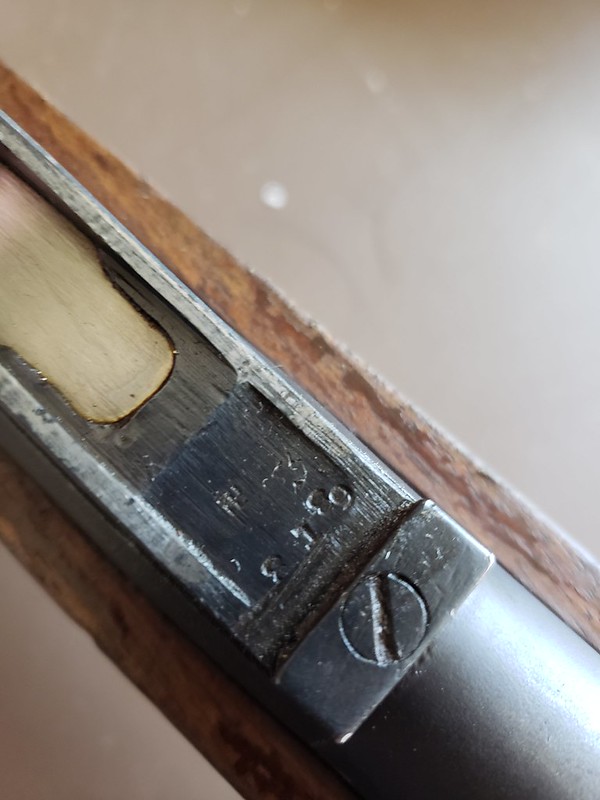

The receiver markings are either partially scrubbed or poorly stamped. It appears to have remnants of an “arsenal 21” stamp from what little I’ve been able to find (but in one place I’ve read the same marking identified as arsenal 41). I attempted to picture it but it is quite faint and may not show up well.
The serial numbers on the barrel and receiver are matching but the double letter prefix is not something I saw on other examples I was able to find. Also the serial numbers were usually shorter. Does have a swastika on the rear sight base but I have read that some of the Chinese arsenals stamped this (to do with Buddhism not as a nazi symbol).

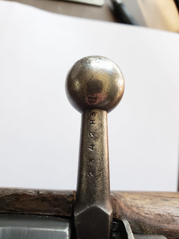

The bolt is mostly non matching (cocking piece matches the safety). The handle has an R4 and Z in circle stamped underneath. I was under the impression that Z in circle was a Czech marking? The bolt also has remnants of bluing while the rifle appears parkerized.
The stock doesn’t appear to be European walnut (definitely not laminated), seems consistent with pictures and descriptions of the wood used by the Chinese. The hand guard was broken in multiple pieces when I got it so it’s wearing one I made.
The muzzle looked like someone had accidentally stuck a stick welder to it and then pull it off, it cleaned up well by cutting back 1/8in and recrowning. Bore is surprisingly good for what I’ve heard of Chinese Mausers. Dark in the grooves but very prevalent rifling. Shot about 3MOA with hornady ammo (which is roughly on par with how well I shoot with irons as I’m rarely below 2MOA).
The trigger guard and magazine is all mismatched, as well when I load 5 rounds, the 5th is very hard to get in and difficult to feed. I’m guessing the magazine parts need some fitting.

Any information appreciated, I apologize for the canted pictures of the receiver marking but it’s the only way I could get anything to show up on camera.
Looks like an old rusty mess barreled action someone tried to restore with a variety of parts. You can still see the putting on the receiver after it being refinished. It's blasted and blued from the look of the pics, not parkerized.
If it shoots good enjoy it. No collector value there. Not sure what you want to modify it into, but it's as good as it's going to get the way it is
I would be very leery of using a Chinese Mauser for any sort of high pressure project. Maybe they're made of quality materials but man are they crude. I've had a number of them over the years and the fit and finish on most is absolutely horrendous. Buy a quality action. Why put all that work into something of questionable quality? For 3-350 you can buy a complete FN M98 rifle. Sell off the barrel, stock and whatever else you don't need and you'll have a quality action to build off of.
If you're just going to tinker with this the way it is and shoot it then that's a different story. Go for it. I just wouldn't pour too much money or time into it.

Well it sounds like it isn’t worth much as I suspected. I would like to completely disassemble and do a full refinish as it sounds like no one will be upset if something goes wrong in the process. I’d like to try re-blueing a gun. If the chamber is huge I might try set it back and clean it up. Mostly just a practice gun.
