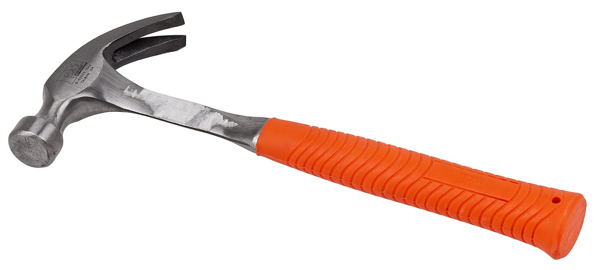

Are you using the official commie rifle armorers tool?
Joking aside, sometimes they can be very tight as the wood may have swelled. Give it some gentle persuasion with the above tool and a wooden dowel.

I tried lightly tapping it with a punch and hammer, no go. One thing is the action and mag is loose in the stock so its stuck on the action somehow.
Alright, sat down and finally managed to pull the magazine out. Took some mild persuasion with a small hammer and a punch.

That's what they mean my "force matched", the magazines were forced in with a hammer. Once you've pounded it out with(wooden dowel and hammer as suggested) you will likely have to do a little dremeling or filing to get it to fit properly. I had the same issue with one of mine. Good luck.
