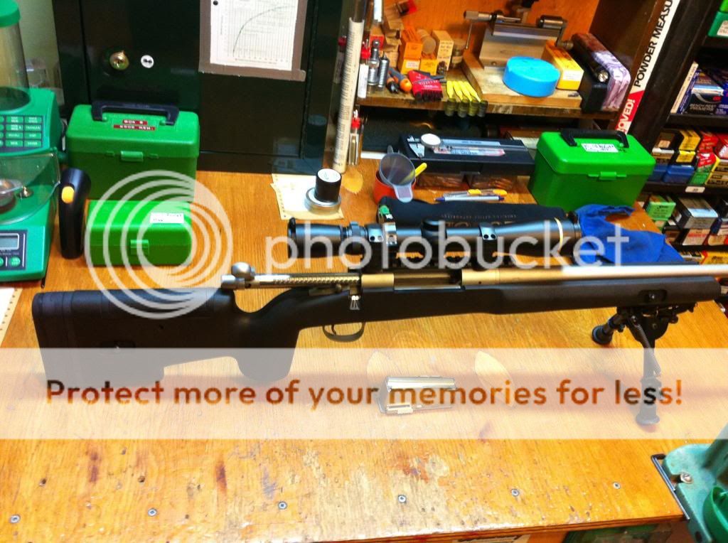

I got my Choate "custom" Tactical for the remington Long action from Jerry at mystic precision two weeks ago.
I really like it!

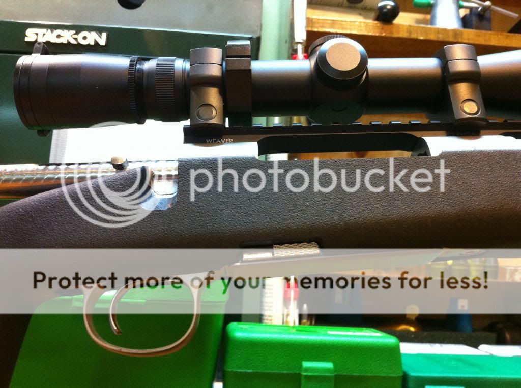

I tried the bottom metal of a few Rem long actions I have, and they fit snug. No problems there.
The rifle I have slated for this stock is/was a Remington 700, stainless Sps, with a detachable magazine.

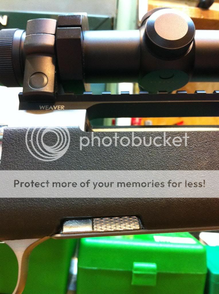

When I got this stock, I had to do some minor modifications to facilitate the bottom metal.
I had to machine about .020" off each side of the magazine well with a nice fine file. Easy stuff.
Once the bottom metal fit in nicely, and the bolts fit into place, I had to cut the knotches for the detachable magazine release buttons.
For that, i installed the bottom metal, and worked the stock material down with careful draw filing. It worked great! That stock material is seriously tough stuff!

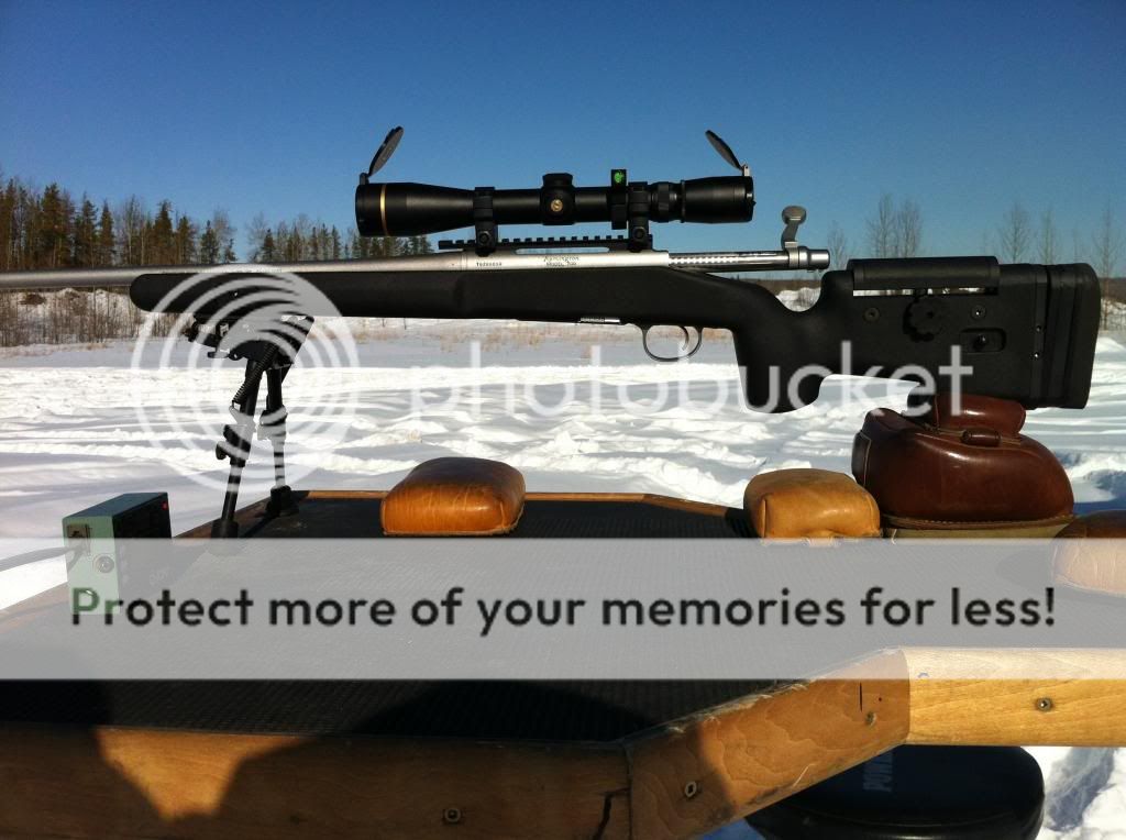

Hope you like the pictures guys!
On a side note:
This "custom" Choate Tactical stock has the 3way adjustable butt plate. I installed a Pacymer butt pad to the stock, to help the butt stick into position in my shoulder better. So far I like it!
