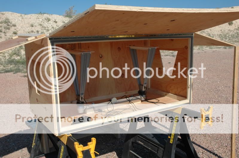

This is what you need, a chrono coffin.
You will also need IR sensors for the chrono too.
The chrono distance from muzzle to the start sensor is 10 feet for IPSC/IDPA and USPSA.
I use this setup all the time at matches.
