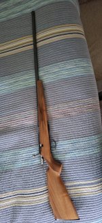

This is the rifle. A sporter with standard barrel. Optics will be 3-9x40mm max. Trying to not dominate the rifle with oversized optics8746.jpg
I've had a couple rimfires with that rounded receiver-top profile that can be a problem for scope mounting. I've found that Millett rimfire rings work beautifully, they have a concave underside that fits those rounded receivers. Clamping screws on both sides allow for a wee bit of windage adjustment, although of course the round top limits that. They're nicely contoured and finished, solid steel, very decent rings.
No idea if they are even still made, might have to haunt gun shows to find any.
