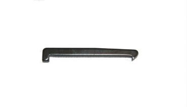

The extractor has a sharp hook. It's on the right side of the bolt. It's shown below.

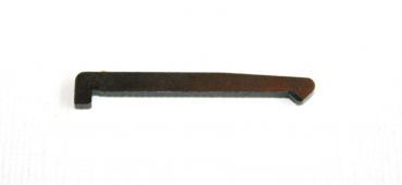

The cartridge retainer doesn't have the sharper hook. It goes on the left side of the bolt. It's shown below.
