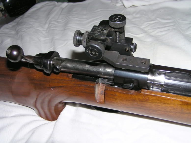

Did you use the Central model made for thr No4 LE with the top mounted adapter plate, or a differnt model and mounting?
Here is what my setup looks like.
A friend loaned one to me chambered in 6.5x55 Swedish Mauser that was set up for "F" class...(tasco 20x SS) shot a lot better than I could.. and a real pleasant rifle to shoot...
It's my main competition rifle these days, set up with a Central sight and a McLennan .3070 Palma barrel.
