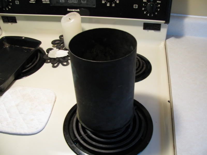

The original state. Old, corroded, black and dirty. I started by washing the whole thing down with soap and water, to get rid of any grease on it.
The primer was loose, so I tightened it finger tight, and ran the hot water into it from the tap, as hot as it would go, to preheat the shell.

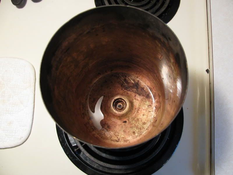

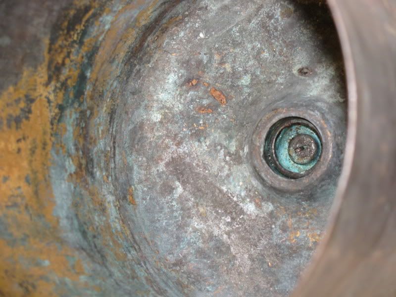

This is what the inside looked like.
I ran the shell full of hot water from the tap, added two heaping tablespoons of Citric Acid Powder to the water and stirred it. I then went a surfed CGN for a while. After 20 minutes, with one interim stir, this is what I got from the inside.

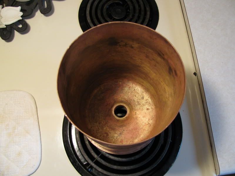

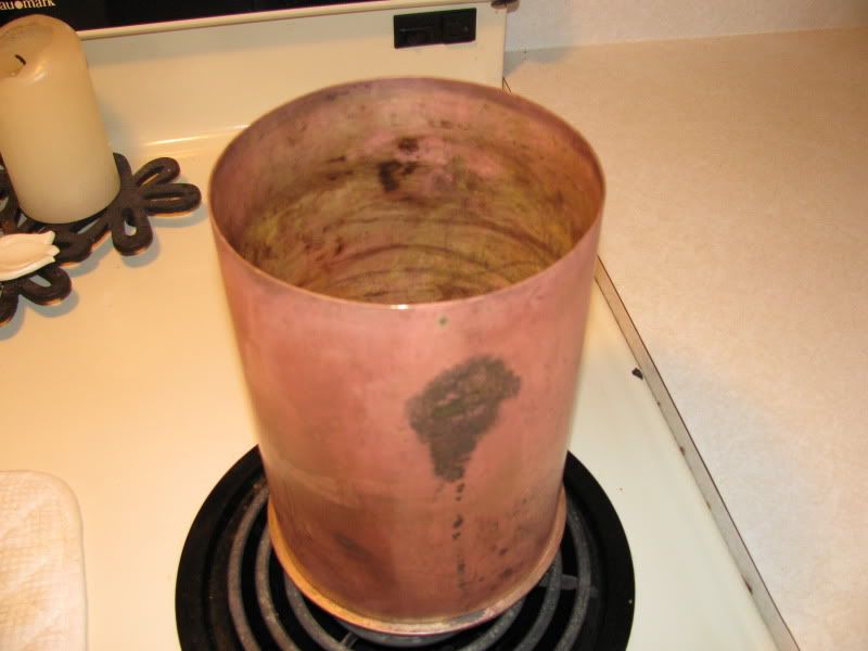

Heres what I got.
Inside.
Outside.

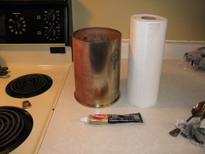

About three minutes effort with some polish and a paper towel, and I got a pretty good shine happening. The red color (copper, left on the surface by the acid eating away the corrosion) vanished really rapidly under the polishing cloth.
For the interested, the markings of the case.
