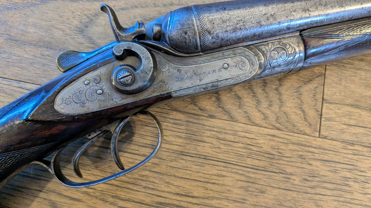

Charles Stark & Co. was a prominent Toronto-based retailer in the late 19th century, originally founded by Charles Stark—an English émigré to North America—who transitioned from jewellery into firearm retailing. By the early 1880s, the company had become one of Canada’s leading gun sellers, famed for its richly illustrated, mail-order catalogues that predated and even outshone early publications by competitors like Eaton’s. He also made a lot of efforts in popularization of firearm sports in Canada.

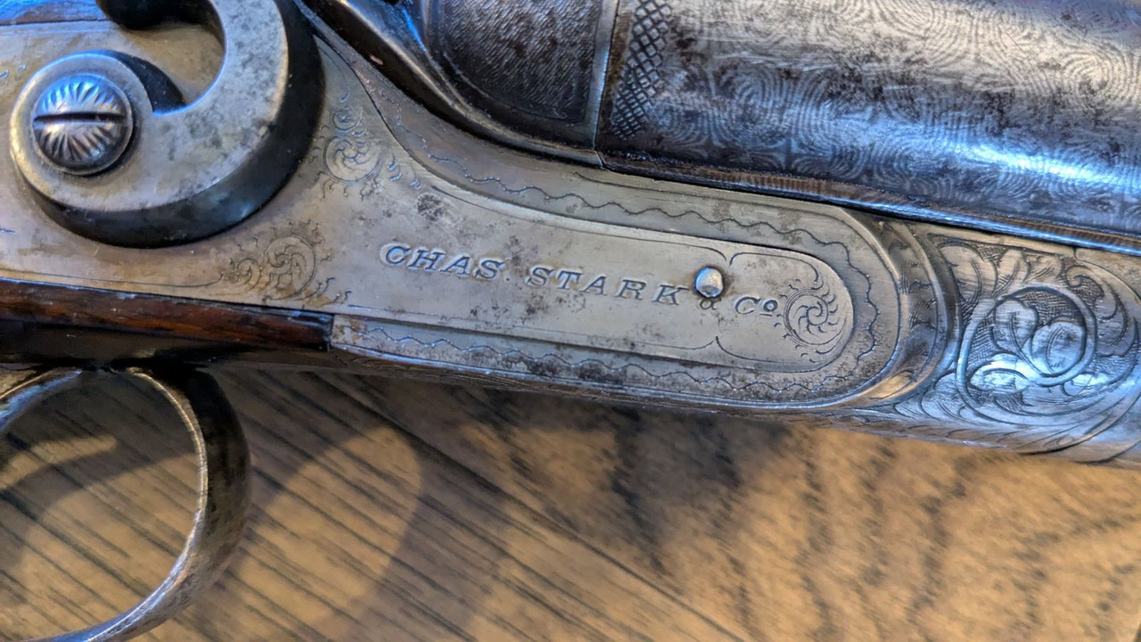

When I read about the story of this business operating out of Toronto (where I live) I thought I can't pass this gun. Also helped the fact that I could not find any references to Chas Stark house branded shotguns and I like odd and uncommon things.

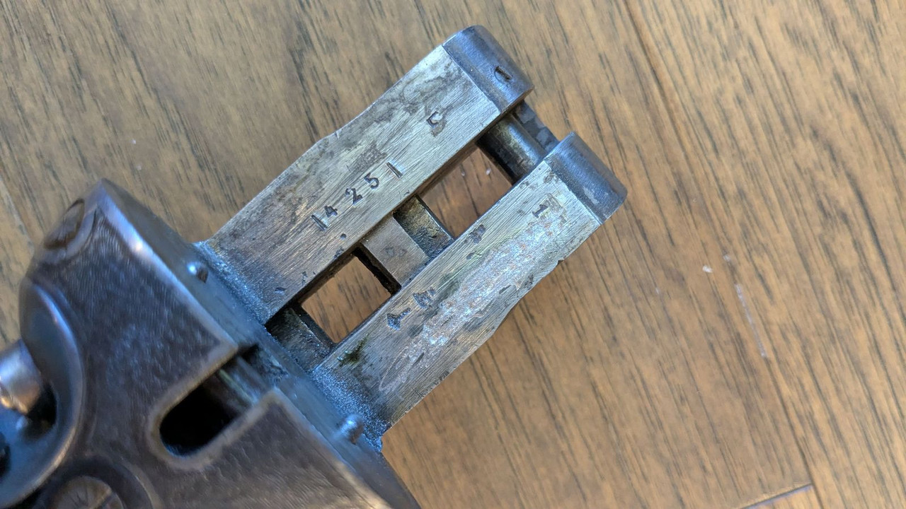

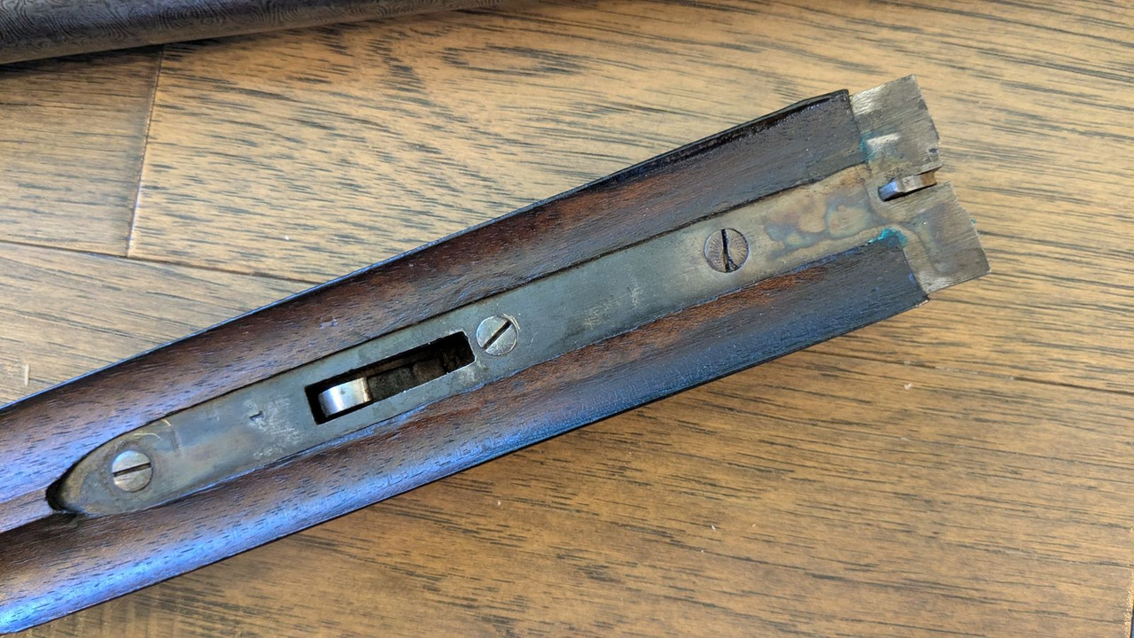

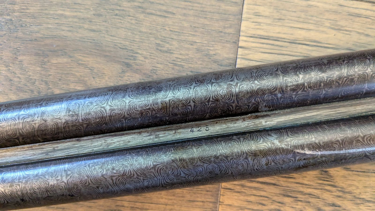

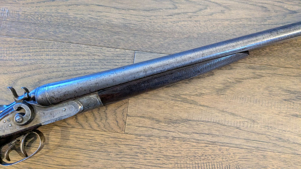

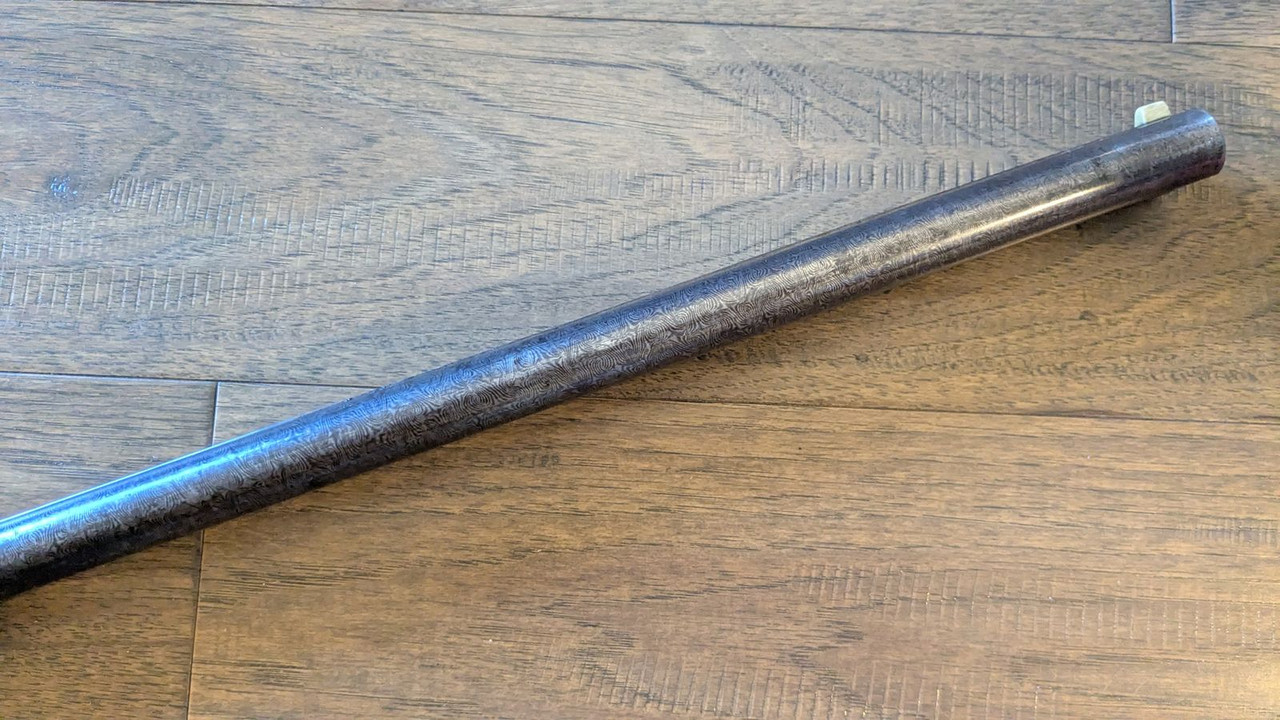

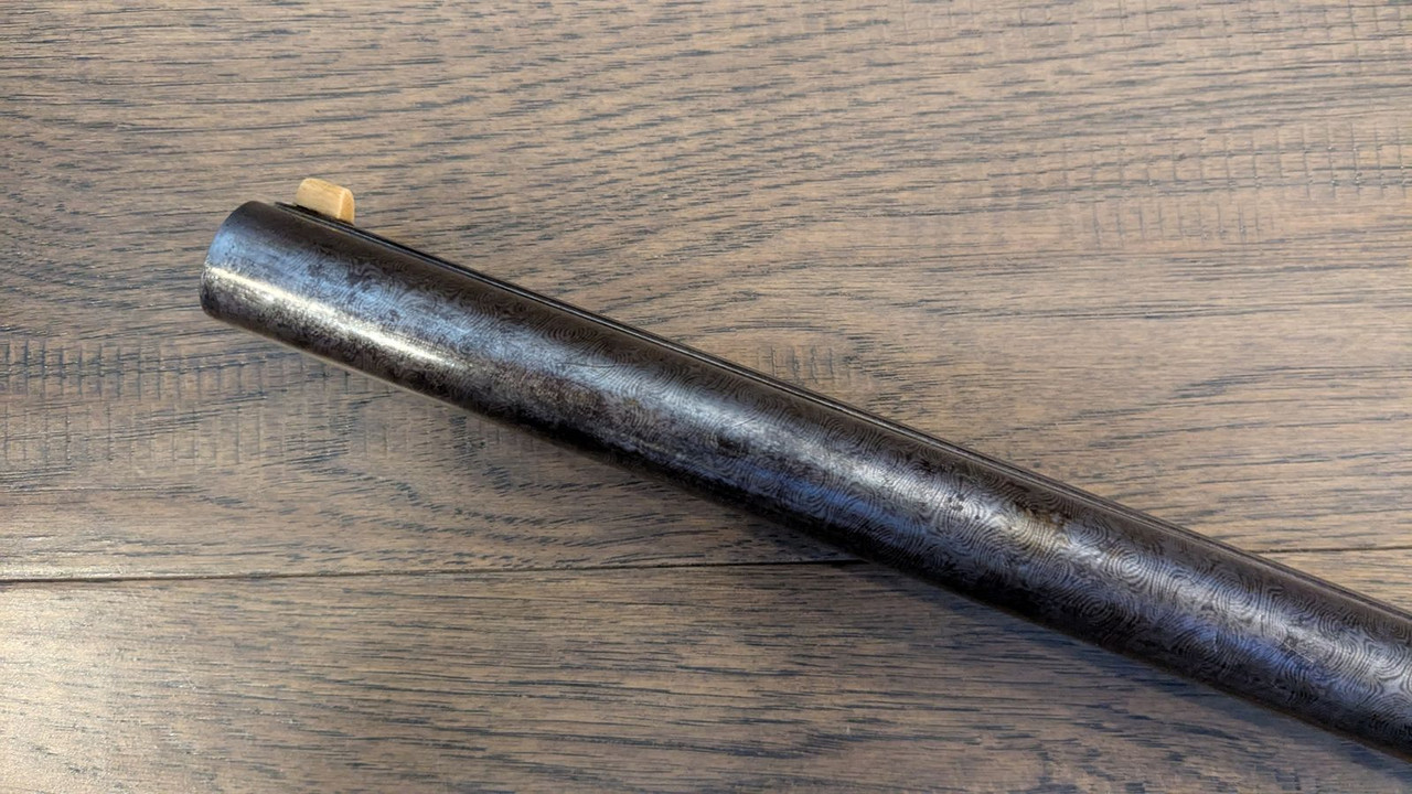

This is how it arrived, no cleaning yet. Smooth and tight. Front bead has an "improvement", however I hope it was installed on top of original bead. The only other "loss" is something ground off flats, probably SIN number of one of the owners.

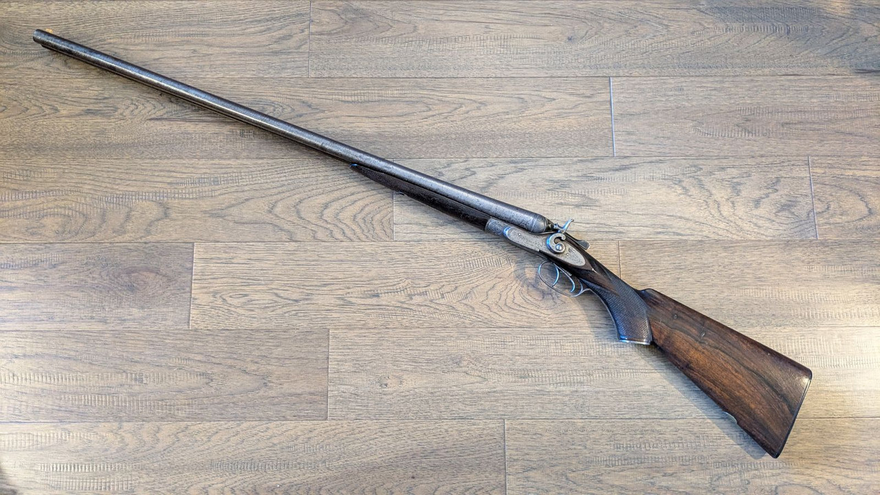

Shotgun itself turned out to be Belgian made 12ga, Damascus barrels. Matching numbers on flats and barrel, no serial on forend. Shotgun markings don't allow me to date it. However Chass Stark started having financial troubles in 1892, died in 1899 and business closed in 1905, so I assume it is post 1887 (absent in 1887 catalogue) and pre-1892.

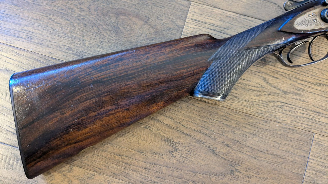

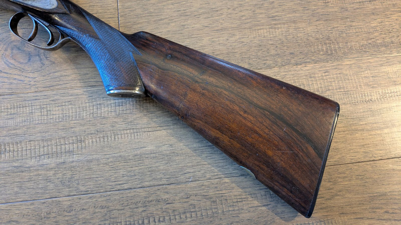

If I were asked to guess, I would have thought it English. The care to fitment and wood selection for the stock is not something I've ever seen with a Belgium made side by side fowler. What a wonderful shotgun. I'm amazed at the lack of shrinkage in the woods. Once cleaned (I really hope that case hardening comes back), get the conservators wax out and seal it, inside and out.

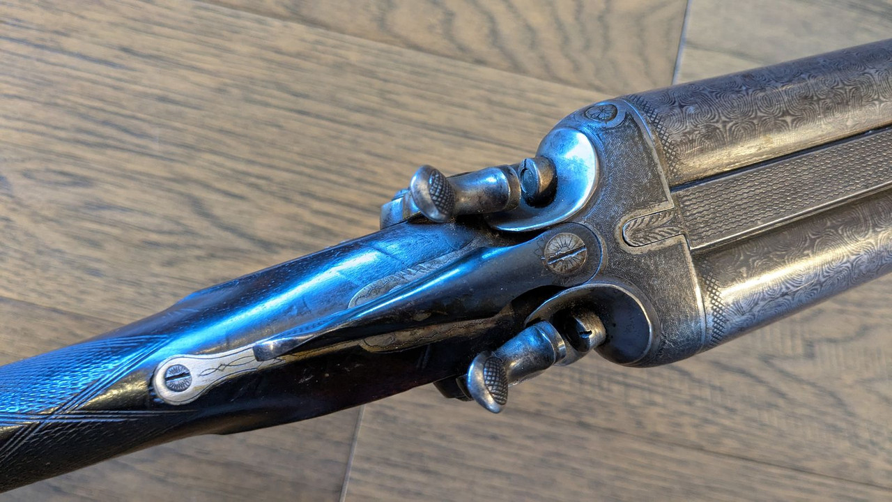

The stock grip and the hammers however, positively mark it a Belgian gun.
I have seen some very high end work come out of Belgium, but for the most part, yes, most of the guns we see were lower end "hardware store" guns

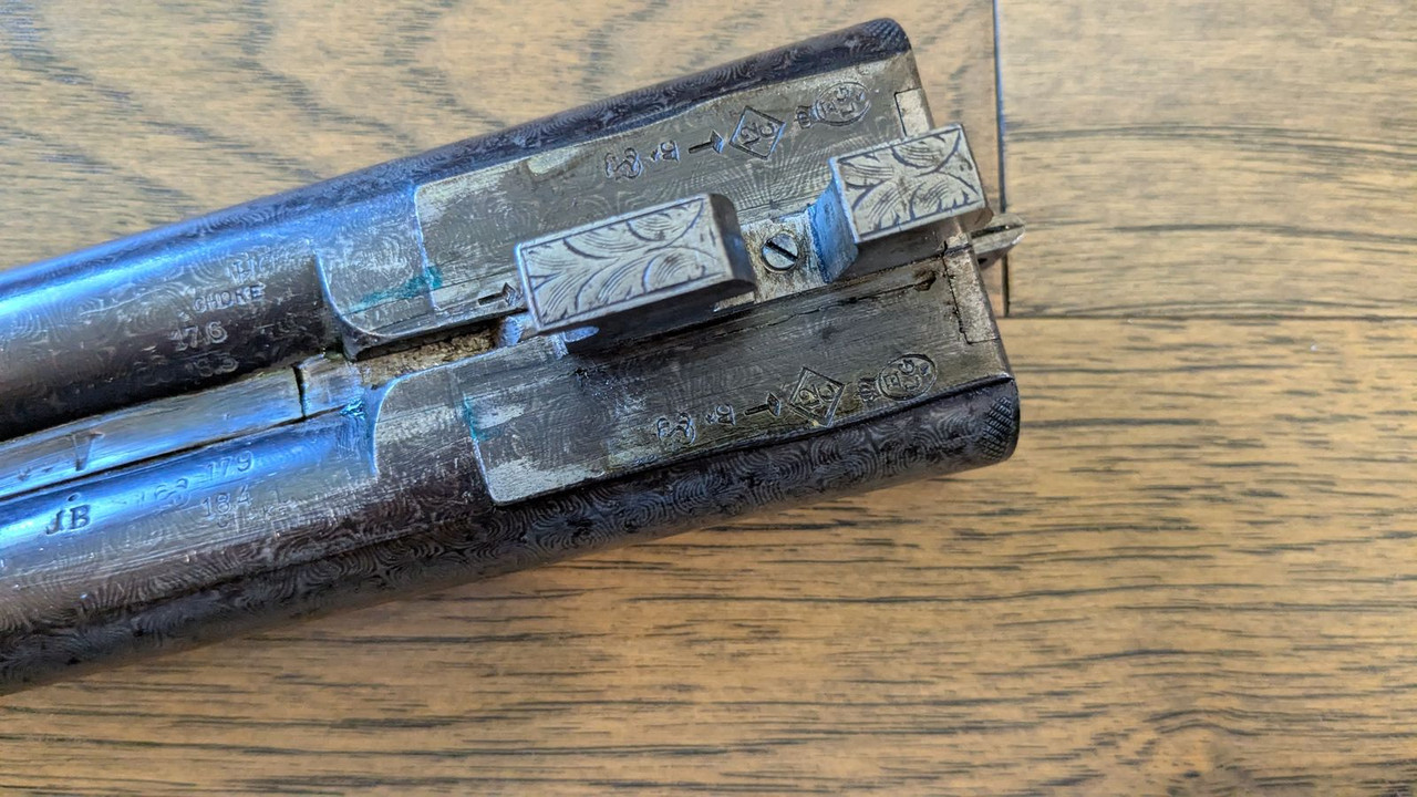

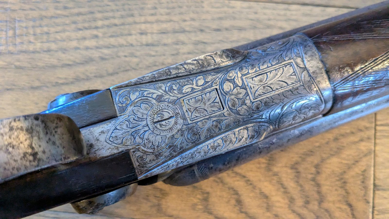

The 12over C in the diamond is a black powder proof mark between 1898 and 1924, the choke designation was used also from 1898 to 1924.

That certainly narrows the date down. Somewhere between 1898-1905. If there's no choke designation...early 1898 would be the year?
Proof marks on the barrel flats and water table definitely identify it as a Belgian-made gun. Quite a few samples of these around. Sold under various names. Stark, included.
