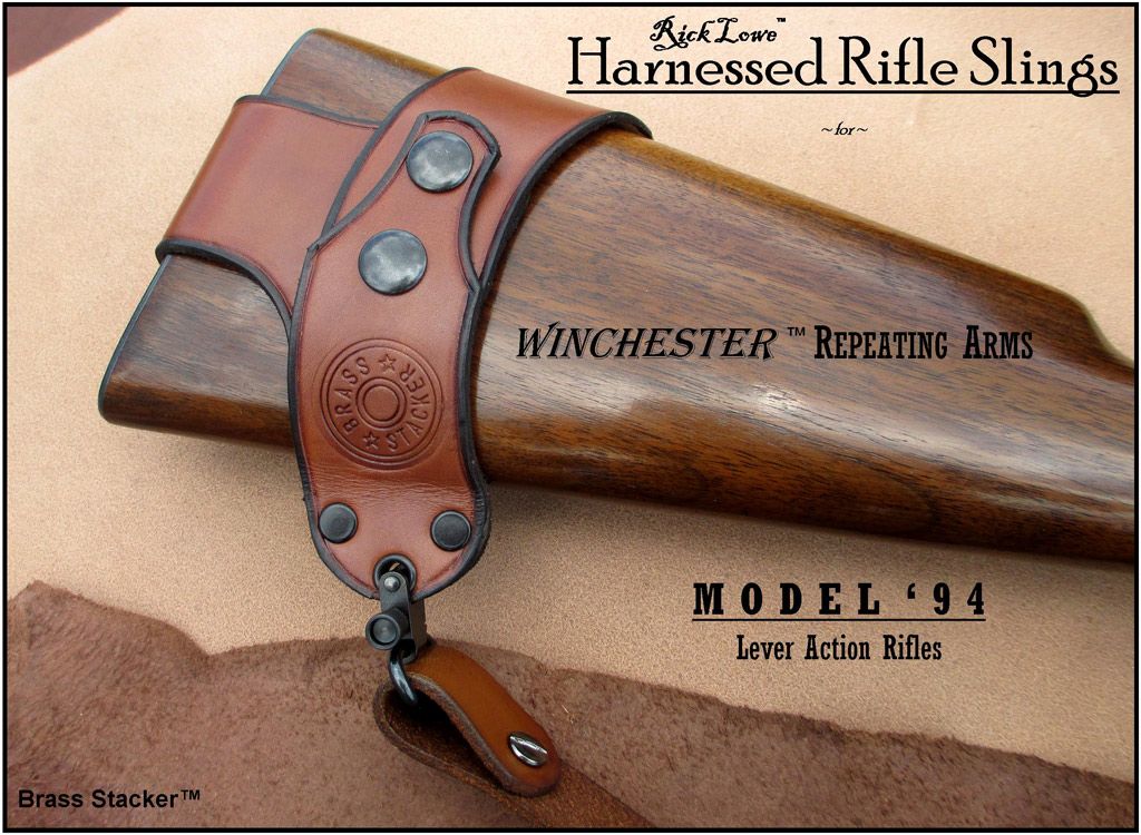

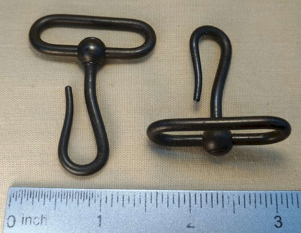

Speaking of putting a sling on a shotgun without swivels/studs.
A number of a years, I'd came across a guy who had (what I think) a pretty idea. The guy a nice old SxS, to hold the sling in the front, he had something like this (made out of kydex and leather lined) with a sling stud
And a harness for the buttstock
