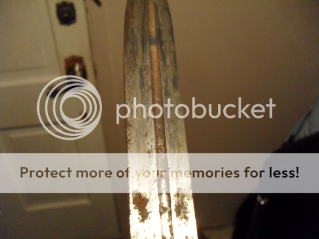

Hopefully this will give you an idea of how it's doing.

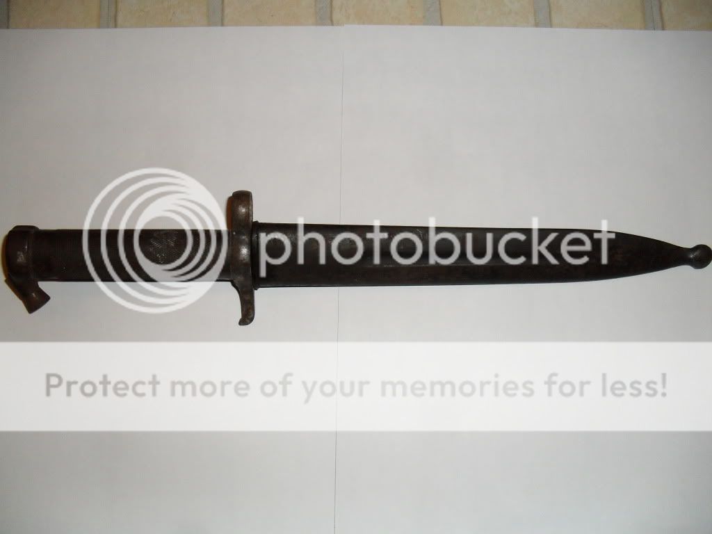

Here's the sheath

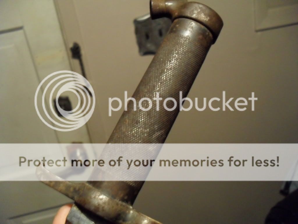

Handle

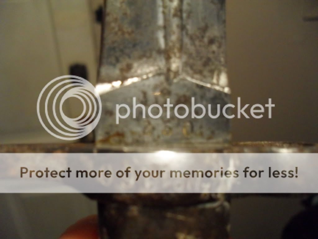

Blade

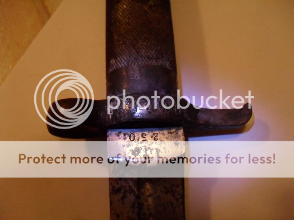

The stamps. In the second/third picture you can somewhat make out an anchor, so I figure this was for the Swedish navy

A combination of gun oil and 0000 steel wool should take care of 95% of that ugly rust.

Use 0000 wool and oil if it is lite rust it might look like something. Polish the blade after an attempt to clean it.
That can be cleaned up, but micro-pitting will remain. These are readily available in fine condition, so that one is only worth maybe $10 as stated. I would not have bought it that state.

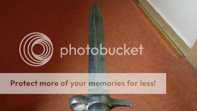

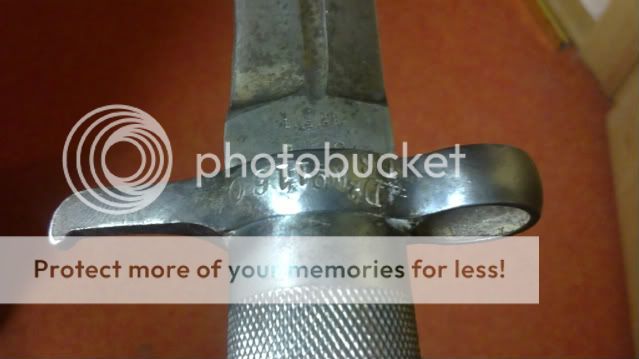

A few weeks ago I said I would, I did, and didn't take any photos 'till now. Hopefully this will cheer up those who were distraught when they saw its initial condition.
There's still a few dark spots which could use more polishing, but I'd say it's way ahead of where it used to be.
