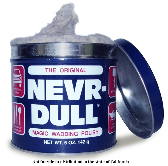

Available at crappy tire... works wonders.
