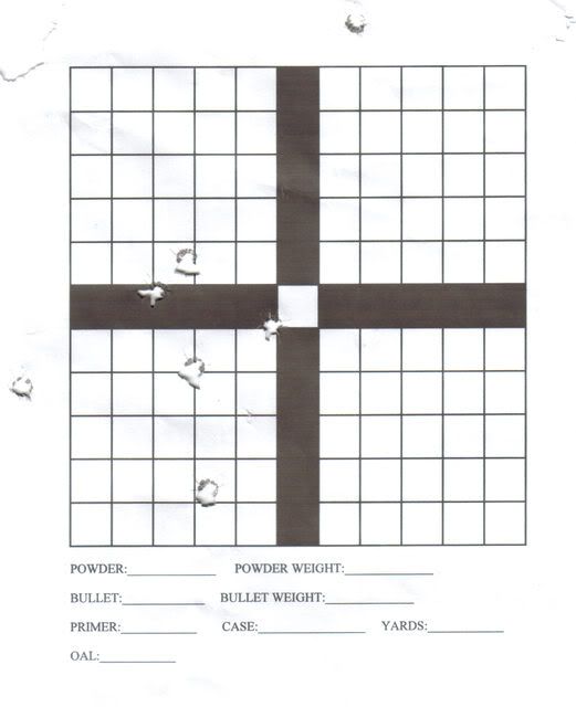

It has a Bushnell 3200 on it, mounted when I purchased it. Everything seems tight. After next weekend I'll be rolling my own for it. See how things go then! Here is a pic of one of my targets, its 8.5x11 sheet, two 4 shot groups, one shot actually missed paper!

It is amazing, the stuff that comes out of a new barrel. I have even had metal shavings appear. Check the barrel bedding for high spots after all screws have been tightened. After the first 20 rounds, do a good cleaning with a copper remover and try again with the same ammo. If things don't improve, its off to the loading bench.
Good Shooting
