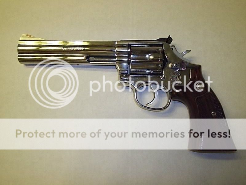

I was in the same position you were--my 23-year-old 686 looked like cutlery that had been banging around the kitchen drawer. I picked up some Mothers Mag and Wheel polish from Cdn Tire last winter and had a go. It took only a few hours by hand with an old t-shirt as a rag, and hardly any "elbow grease" since the polish is very light in consistency. I left the cylinder flutes "as is" to give a bit of contrast. Anyway, I'm very happy with the results:

Holy cow!:eek: That looks like NICKLE finish rather than stainless.

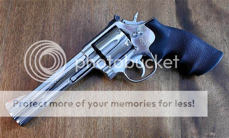

The product I mentioned called "Never Dull" available at Canadian Tire is not abrasive and even with heavy residue buildup you can get this result with a bit (not a lot) of elbow grease.
