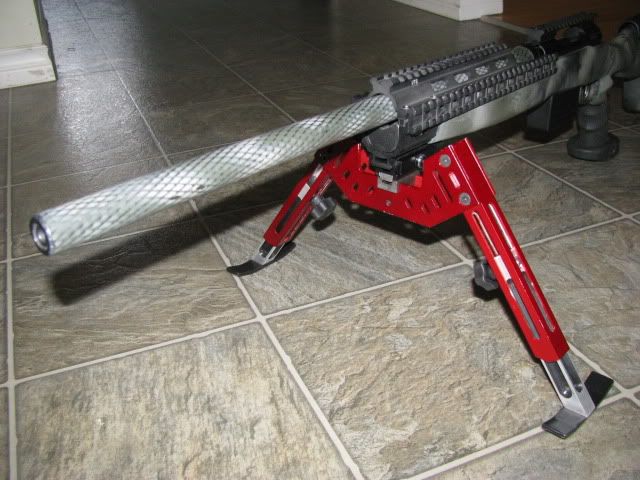

I recently ordered an Atlas bipod and noticed that they have the option to add cleats or ski feet. I have never used either on a bipod, just the regular Harris. So I was wondering what people prefer. The reason I would like to add these feet is I noticed when shoot off the regular Harris, the feet gradually dig into the ground.
My main focus when shooting is precision. I have noticed the F class crowd seem to like their ski feet, but have not been to enough precision events to make a call either way.
What do you guys like to use?
