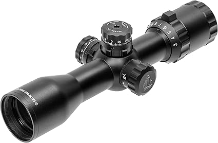

UTG BugBuster Riflescope, 3-12x32mm, 1" Tube, Side AO, Mil-Dot Reticle
- Parallax Setting: 3Yds - Infinity
