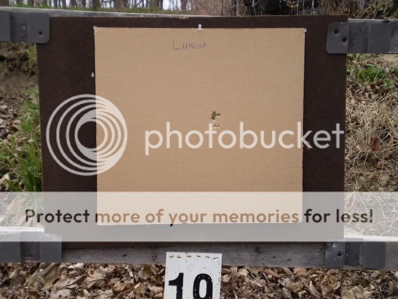

Since it clearly seems to be legal to at least be curious about the utility of such rounds, I present a test.
The test was as follows: target @ 25yds., target size 20"x21", Shotgun Rem 870, 18" bbl, cyl. choke (no choke), smoot bore.
The ammo was Winchester 00 Buck Super X.
The whitness shot looked like this:

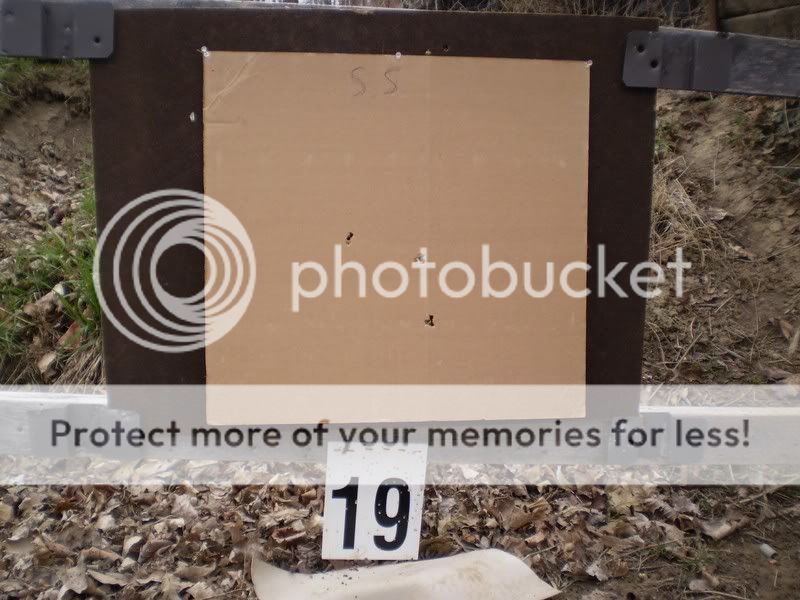

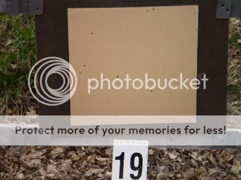

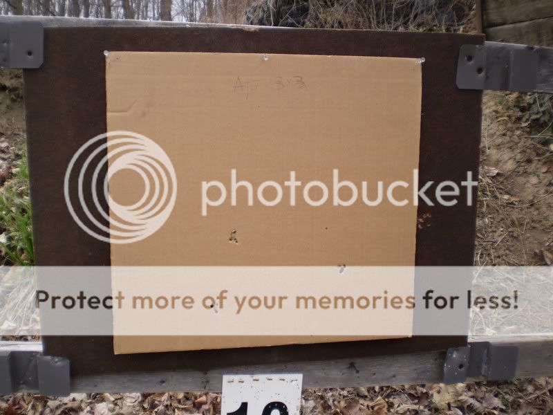

since there were 9 balls in that shell there were two distinct possibilities. Tie them 3x3 or one long string. The pellets were opened half way and then closed back on the string. The concern about the strength of the string to be used led to testing of both fishing multifillament line (90lbs) and snare wire.
Here's a picture with a shot of a shell with pellets tied 3x3 - with fishing line. The distance between the pellets was 3-4mm.
http://vinatorul.ro/forum/album_pic.php?pic_id=2739&full=true&user_id=754
The same type of tie, but with wire.
This time the string has all 9 pellets attached on it. The string cut the paper and the backboard.
While the 3x3 were all tied in complete circles (the last pellet was clamped on a knot) the last one was a simple line.
The idea that the line would not be strong enough to hold the pellets limited the amount of space between the pellets. It is clear that a little more space would have resulted in a more impressife pattern.
