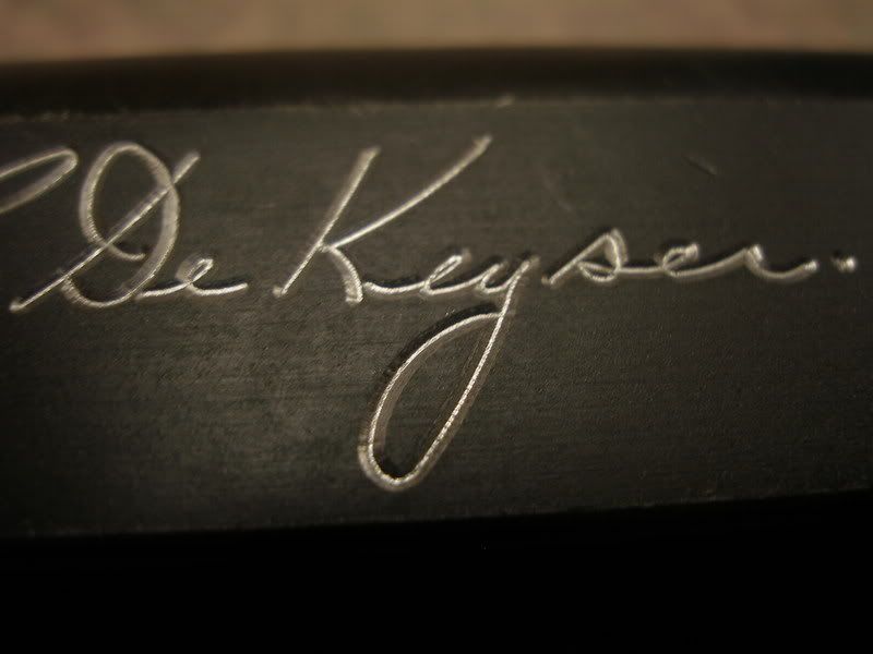

I've done some with an old Bridgeport. I think the drag method is suppose to work well, although I havent tried it.
These are done with a very small center drill fom princess auto.
This is on the side of an old 1911 it's an actual signature.

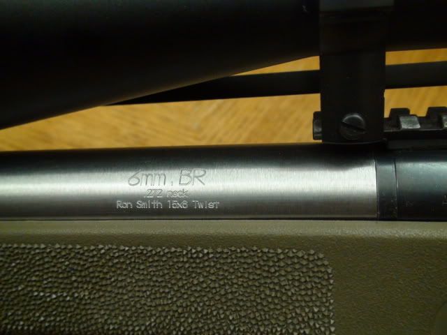

I do drag with an attachment I made. Works very well, diamonds are cheap, not real deep but I go over it a couple of times to deepen. Angle of diamond is important, dont buy from Dremel. Looking for a rotary setup as well.
I have done a lot of engraving with 1/16" and 1/32" ball nose end mills. Flat surfaces only, though.
