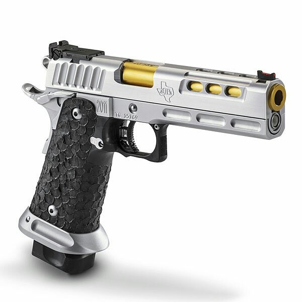

TiN coating can be seen on barrels of high-end racer competition guns like STI DVC and SVI Infinity. TiN is usually the most popular due to its nice golden color. Below are two pictures I took from the Internet that shows TiN coating:

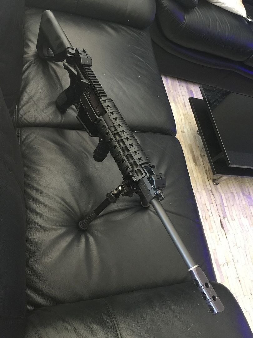

I opted to use TiAIN to preserve the tactical looks of my SIG716 and because it has the highest hardness out of the three, although any of the three are overkill for firearms. Here are the pictures of the results (Any smudges visible are just oil from soaking the parts in Fireclean):
