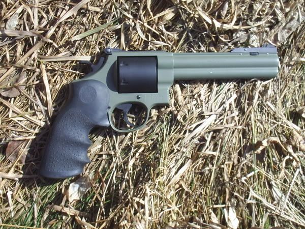

With Arma-Coat you can replicate blueing with a high gloss black and by no means have a Tremclad looking finish unless you give your rifle to uncle Bubba to refinish it for you. Blueing is nice for a classic look but can rust and wear easily, and for parkerizing and you can't retouch it up after you damage it. We use parkerizing as a primer for our coatings. Powder coating can be good but when you do chip it off or scratch it, you cannot easily fix this without sending it back to whoever powdercoated it. And by being ugly I would definately disagree especially when it is professionally done. Here are a few close ups for you to see. Also you can refinish optics with our coating too.The trigger is coated high gloss black on the 1911, also the backstrap, hammer, and beavertail are also high gloss, and the reciever and slide are matte black

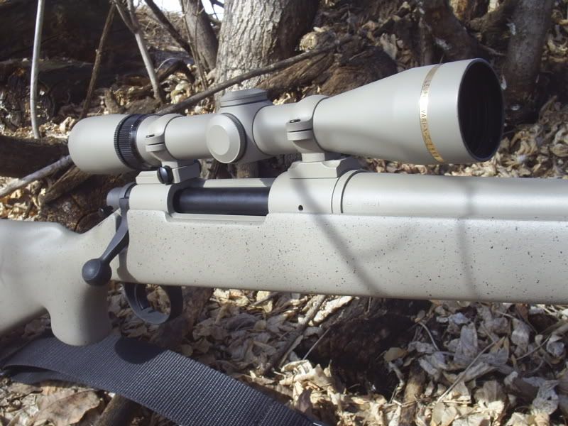

I like my gun-koted rifle. Infact, I take exception to the "coating is ugly statement :p so much so, that I will post pictures of it in a few hours. Guncote is what the USMC are using (The testing specs are on the guncote web page). You can get it in a lot of different colors from "silver" or mat-silver (to look like stainless) to purple, if you so desire to be the laughing stock among your hunting group.;)
back later with pics

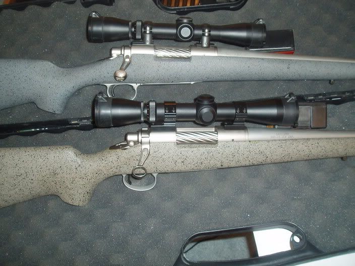

Make my bbls and actions stainless, and if I just have to use a blued action, there is only one way I'll go...
If you want a NO BS finish that is impervious to anything you can throw at it, super durable (moreso than the steel action itself), looks great, and won't change tolerances noticebly (much less than Teflon or Powercoating)......
Electroless Nickel... this rifle has seen hell and back a bunch of times, and will pass for new (the acton anyhow).
Here is another that has had the action Electroless Nickel plated (the other is the rifle in the above picture)

Here's my 6.5x55 "project" or bubba, or whatever you want to call it. (It was already aftermarket when I bought it, so I guess I didn't do the bubba:p :
####ty quality pic, but for context
That's called "tactical grey" gun kote. I like it, it seems very durable, and it's between $130-$160, to get someone else to do it for you.
