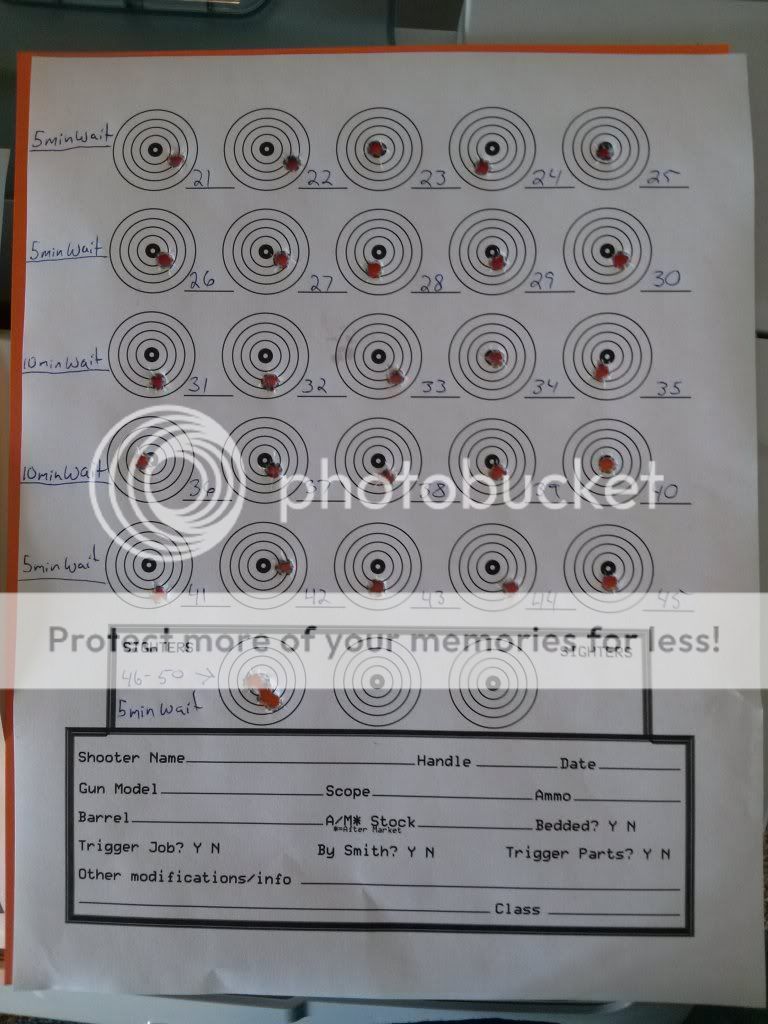

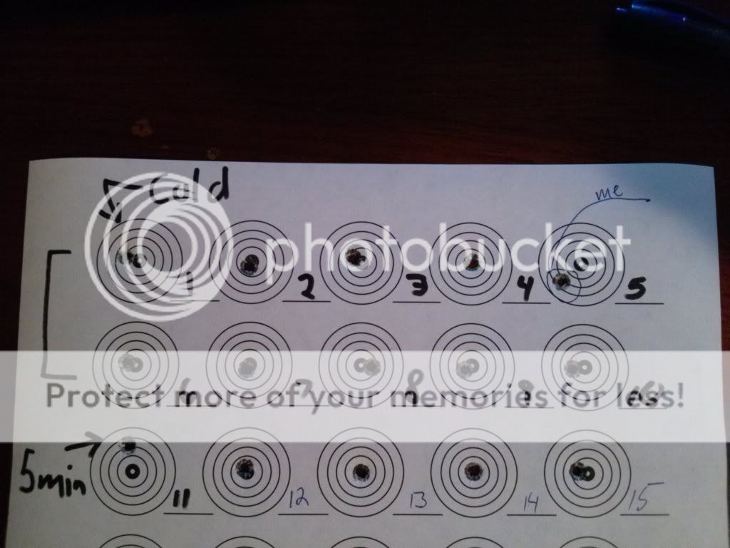

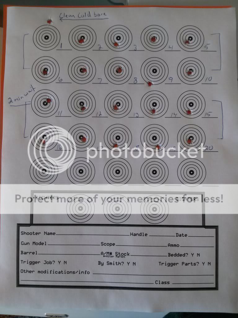

I did some cleaning on the gun to night, I mopped it with hoppe's 9 and brushed the phuck out of it with a nylon brush. and did a 2 passes with the bronze brush. then ran some easly fitting patches followed by some tight fitting. i was getting lead slivers and little chunks of black stuff out. I repeated this process a few times. I should get a chance to go shoot it tomorrow. I think this is the cleanest this rifle bore has ever been in its life.
I went out and shot.
93 degrees
Durring wait time the rifle and ammo were in the shade. and i was working on my tan.
Shot prone with bipod and rear bag.
