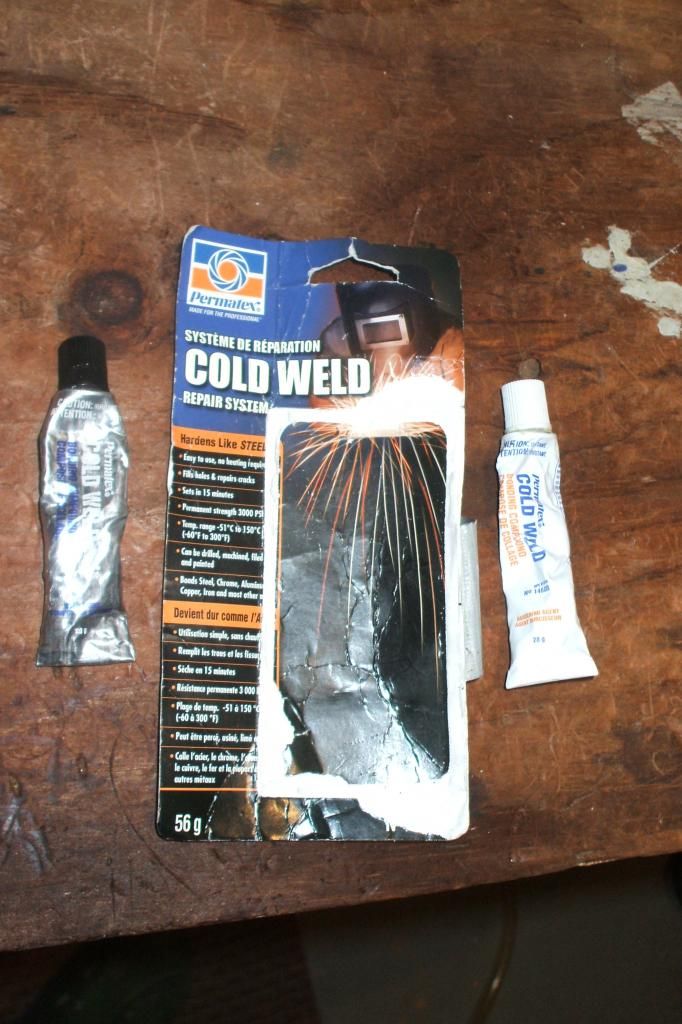

I went down to the workbench and found some old Permatex Cold Weld.

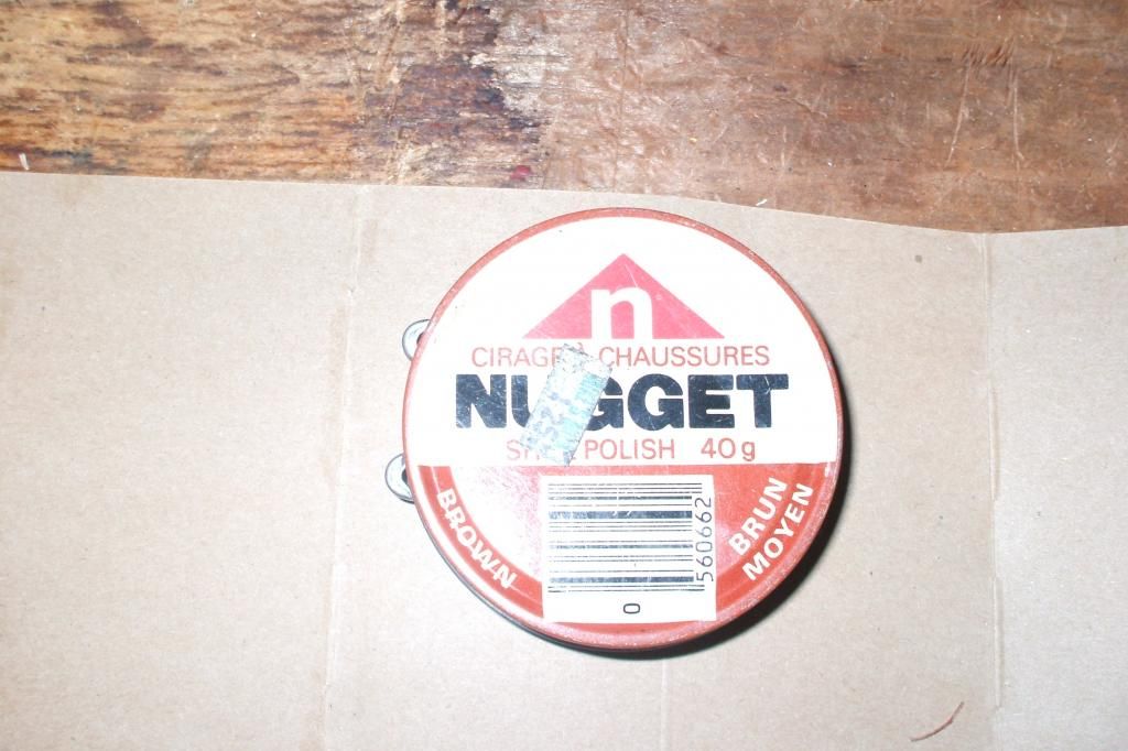

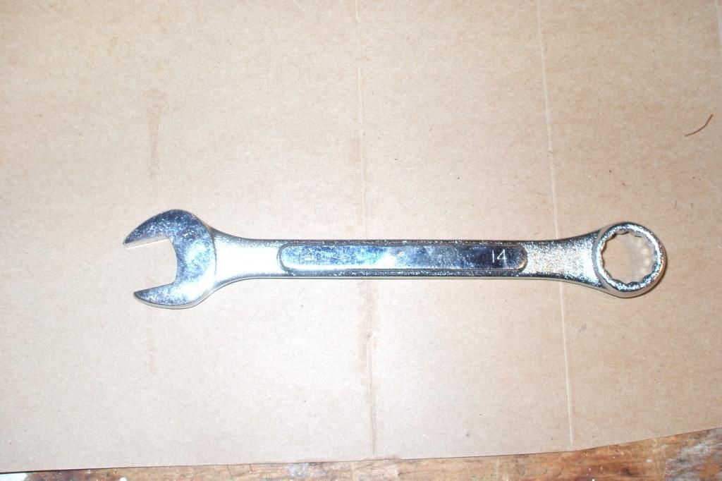

I found a cheap 14mm wrench (didn't want to use something good) and some standard light brown shoe polish (didn't have clear or neutral).
http://i118.photobucket.com/albums/o116/Muskyhunter1/bedding002.jpg
http://i118.photobucket.com/albums/o116/Muskyhunter1/bedding003.jpg

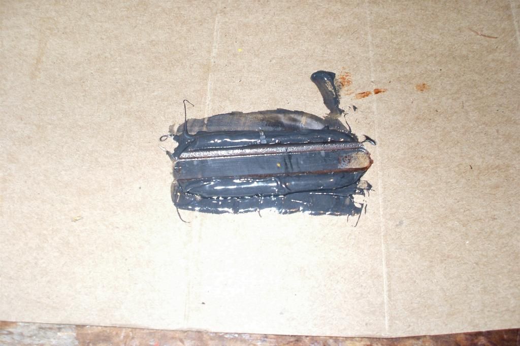

I coated the wrench with shoe polish. I mixed the Cold Weld up on some cardboard and placed the wrench into the Cold Weld overnight to set. Today I pulled it apart and the wrench came out easy. The resulting glass impression of the wrench even recorded the writing on the wrench. It was perfect.
http://i118.photobucket.com/albums/o116/Muskyhunter1/bedding006.jpg
Just suggesting this might be a cheap way to bed a rifle. They say you can even machine this stuff after.
