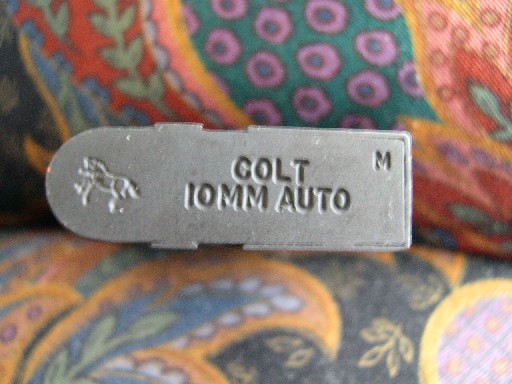

Guess, that's why the Delta mags started out looking like this on the base:

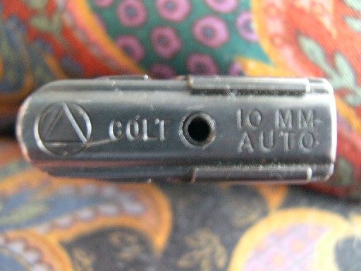

Then they went to these for the later magazines::cool:
A lot easier for take-down.... ;)
hmm, well mine's one of the newer ones...
I don't think I can do what you recommended to the follower... My first instinct was to stick something in the hole in the floor plate and shift the plate, the way I do with my other mags, but it didn't budge. Should I keep at it that way? If so, should I push on the square or the round side of the floor plate?

With that style of Delta mag the base plate is meant to be removeable to take the mag apart for cleaning/inspection, etc. You slide it to the rear [from the rounded side towards the back]. It should come off pretty easy. ;)
+1. Looks like you depress the "ring" in the base plate center hole & slide the plate off. Spring & follower should drop out the bottom then.
