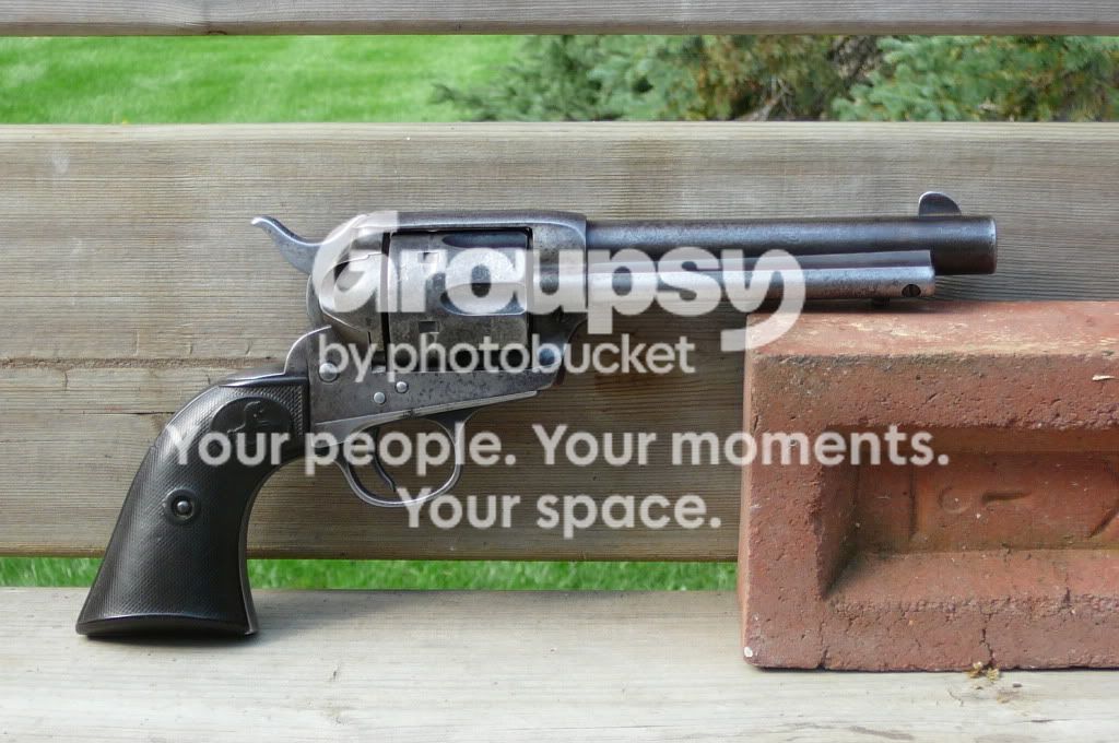

I just got a SAA Colt in nice shape. It's stamped 38 W.C.F. and was built in 1902. What would be it's best ammo without damages? I don't need to hit anything, just make some noise. Thanks.:wave:

Oh yeah! Pictures! If yer gonna brag about a score like that, pictures!:)

SAA pic.
