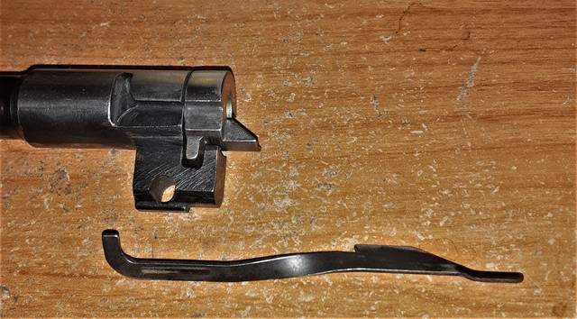

Anyone have some experience? Seems the ejector is about a 1/4" too long to fit in the slide stop.

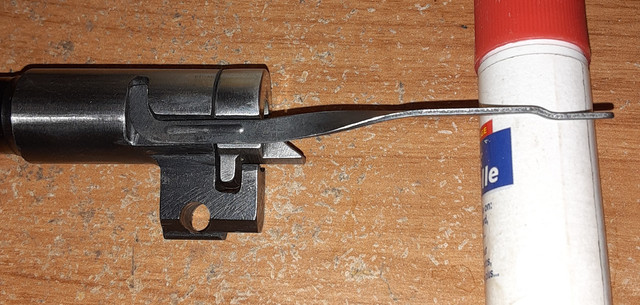

Couple minutes on a grinder removing a bit at a time of the sloped rear surface of the 22 extractor until slide stop could be inserted, and another minute of 1000grt sandpaper on the edges. Slides moves nicely with a little hang up now and then.
Means I might need to take off a bit more and check the angle of the extractor.
Now need a mag to test.

Since I'm missing the magazine, I tried it out single shot and ejection works fine on the ten SK Standard Plus rounds I tried.
Now that it works may also try it on the Llama IXA.
