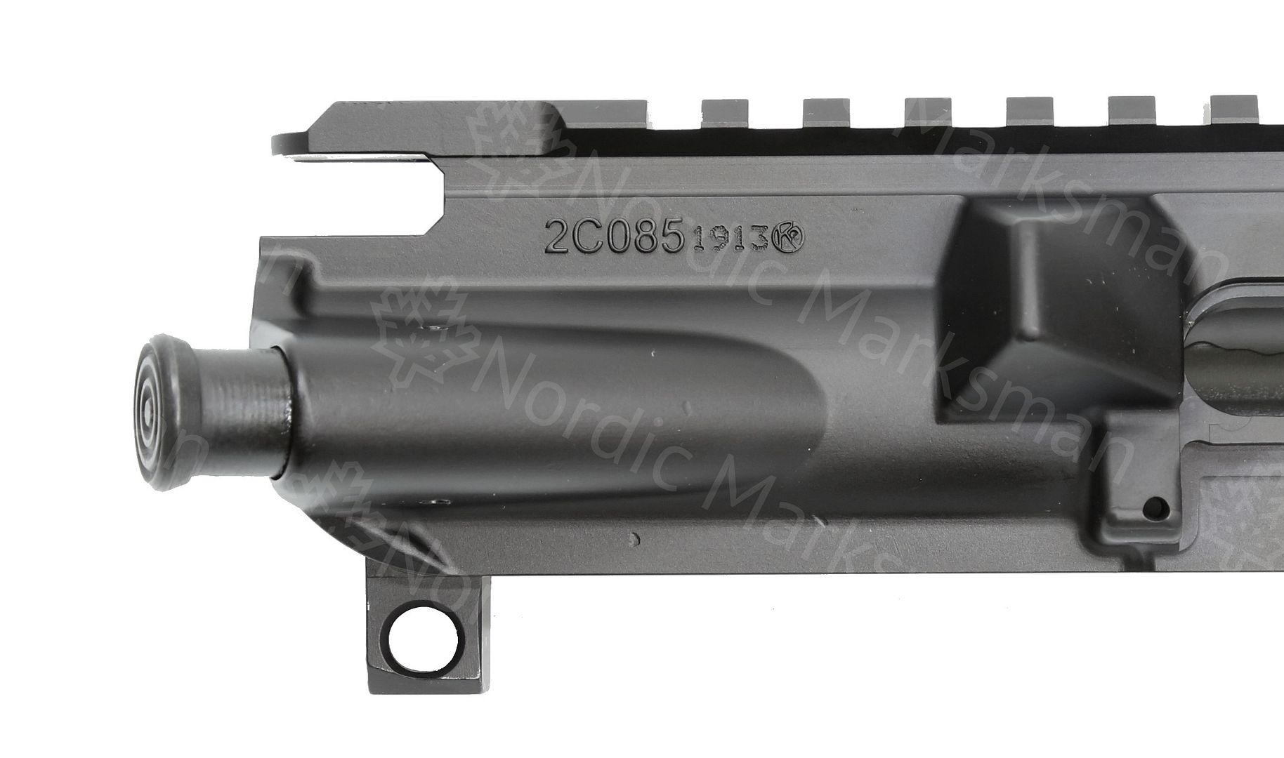

Colt Canada C8 NLD Upper Receiver
Nordic Marksman
74   0   0
These are fun.
Add a C8 carbine barrel assembly and you have the same uppers used on the C8NLD rifles supplied to the Ministry of Defence, The Netherlands minus the FDE doors on the upper.
These come with black doors as pictured. (FDE are not available).
I couldn't resist putting one together to see what it is like. I love it!
If your thinking of doing a build, we can also supply the correct take off C8 barrel (same as used on the build below).
We also have some NEW in the box Diemaco C8 barrels.(due to limited numbers, C8 barrels will be only available for customers purchasing the C8NLD
IUR from us) Can also build a complete upper for you, please inquire pricing and options to info@nordicmarksman.com
A complete C8NLD Upper with C8 barrel weighs in at 3.36lbs (excluding the BCG & CH)

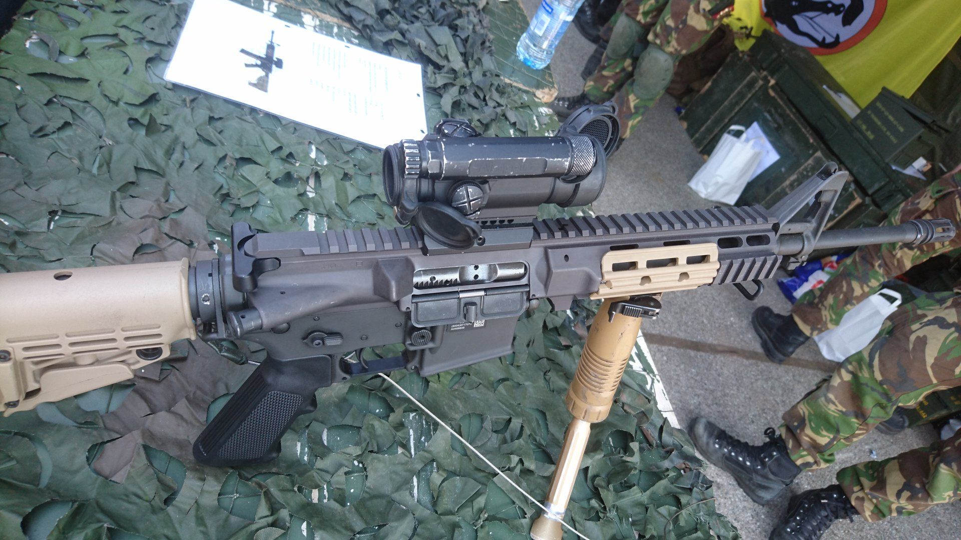

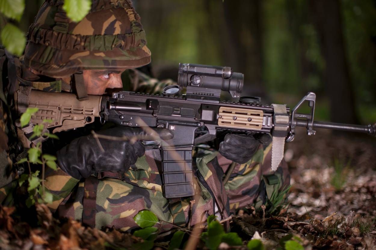

Some photos of in service C8NLD rifles.
Are any of the parts/uppers/complete rifles of the Netherlands available in Canada?

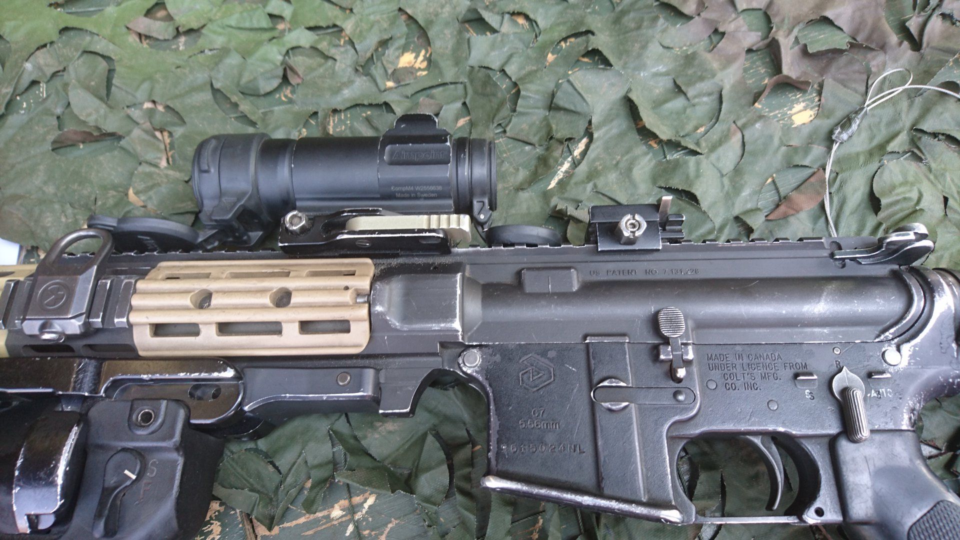

I noticed on the pic with the C8 lying down with the grenade launcher that the lower has the S-R-3 markings for fire control under the (presumably newer) paint markings. Did CC initially do a run of 3 round burst lowers for the Dutch or was "3" the marking for "Auto" before?
Their 3rd setting is auto as well.

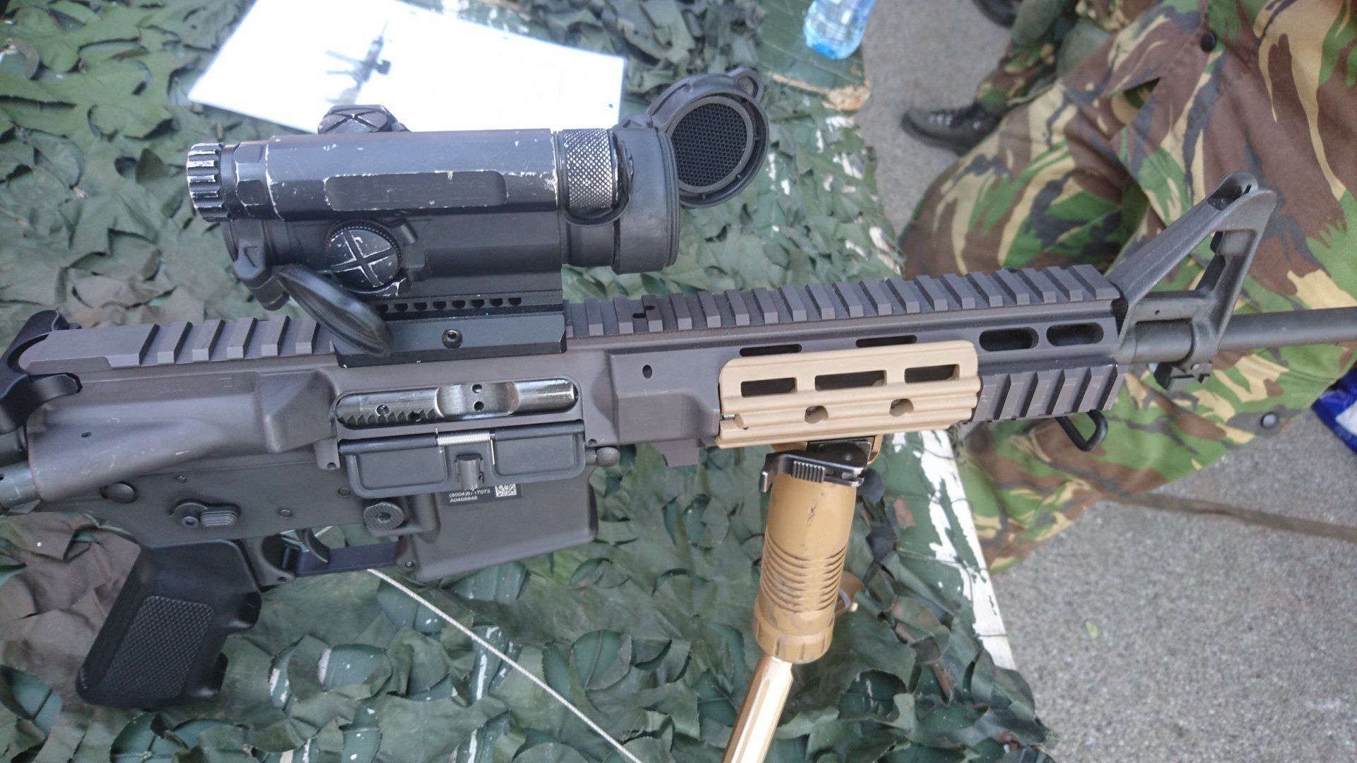

Also interested in accessories
Aimpoint comp m4, 3x aimpoint twist top magnifier
B&T Grip bipod, or magpul afg2, magpul asap sling plate. Not sure who makes the stock.

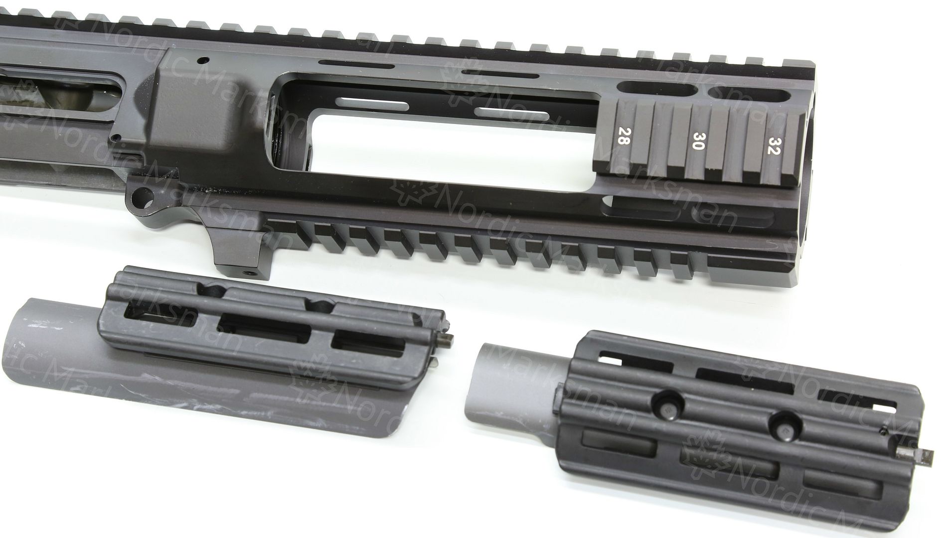

Whats the point of the doors?
From the listing:
These first generation uppers come with aluminum-lined glass fibre "side doors" on the handguard, which can be easily removed to allow the barrel to be installed with a short, but specialized, barrel nut wrench. It uses a standard gas tube.
Gen 1 IUR use the gi barrel nuts. Those doors allow you access for the wrench.
Gen 1.5/2 is what the danish bought which iirc started using the propietary cc barrel nut and wrench but still used the standard gas tube.
Gen 3 or the cansofcom/sas started using a propietery gas block, straight gas tube, and some gucci coating on the barrel behind the gas block.
Mrr has the mlok handguard vs the gen 3 iur which has the pic. Their barrels are lighter profiles. Otherwise they retain the other technical propietary parts of the gen 3 iur
This upper cannot use the GI barrel nut - look into the receiver and see the thread.

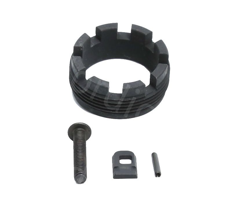

These uppers come with the barrel nut. Its the same nut that is found on the latest generation IUR's from Colt Canada.
A standard barrel nut will not fit inside the IUR.
For barrel installation you do require a tube style IUR wrench. A wrench was made for accessing through the side panels, but was never sufficient for achieving the required torque so it never made it to production.
We are working with a local machine shop to produce a Quality Canadian Made wrench.
More details on this shortly.
In order to install a C8 style barrel, the front sight post will have to be removed to install the barrel. That's what we did with our build.
Below is a picture of the items that come with the upper.
