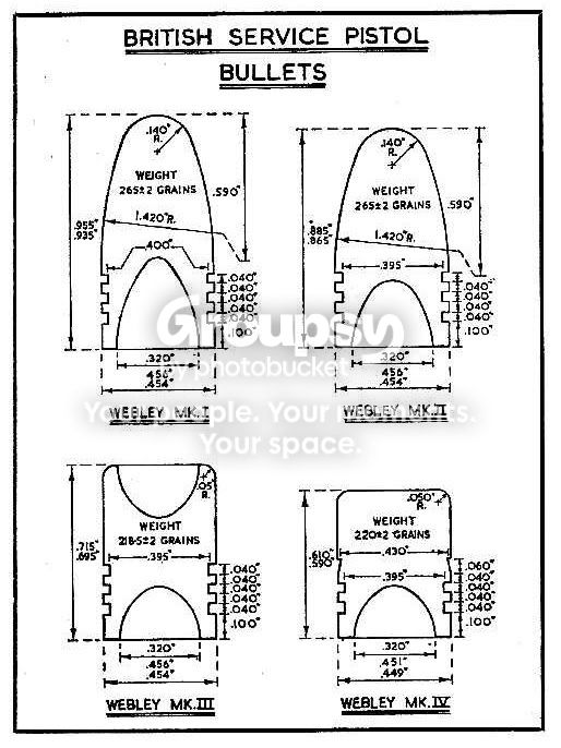

The .455" was initially issued with a the familiar MkII RN bt but c1900 the MkIII hollow nose bt was introduced to increase stopping power. This round was found to be contrary to the Hague convention and was replaced by the MkIV and V ctgs which used a full wadcutter bt. During WWI the MkIV and V were replaced by the MkII since the Germans claimed they were inhumane. The .455" gained its reputation when loaded with MkIII-V ammo.
Any pictures of the full wadcutter ammo they used in the MkIV-V?
These specs were originally posted by GrantRCanada on the British Militaria board, copied from "The Webley Story." I hope he doesn't mind me re-posting them.

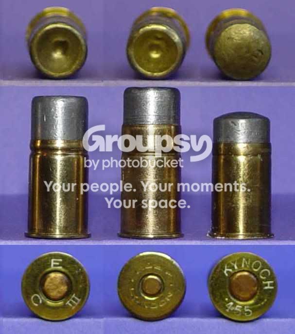

This image shows a MkIII cordite cartridge on the left, MkIII BP catridge at centre, and at right a Kynoch .455 wadcutter cartridge that resembles the MkIV wadcutter but has a slightly different bullet profile. Can't remember where I found this...

Wow. When you said full wadcutter, that was what I was picturing, but I'd never seen a factory round with a flat end like that before. Only target loads.
