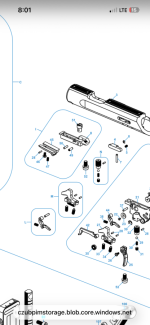

If you look at part #51 it’s way different than a mag feed ejectorAll those race-y go fast bits and they still won’t have fixed one of the main problems with the 457 - ejection.
So cz will quietly roll out a farewell 457 model and make a 459 with minimal parts that transfer over
