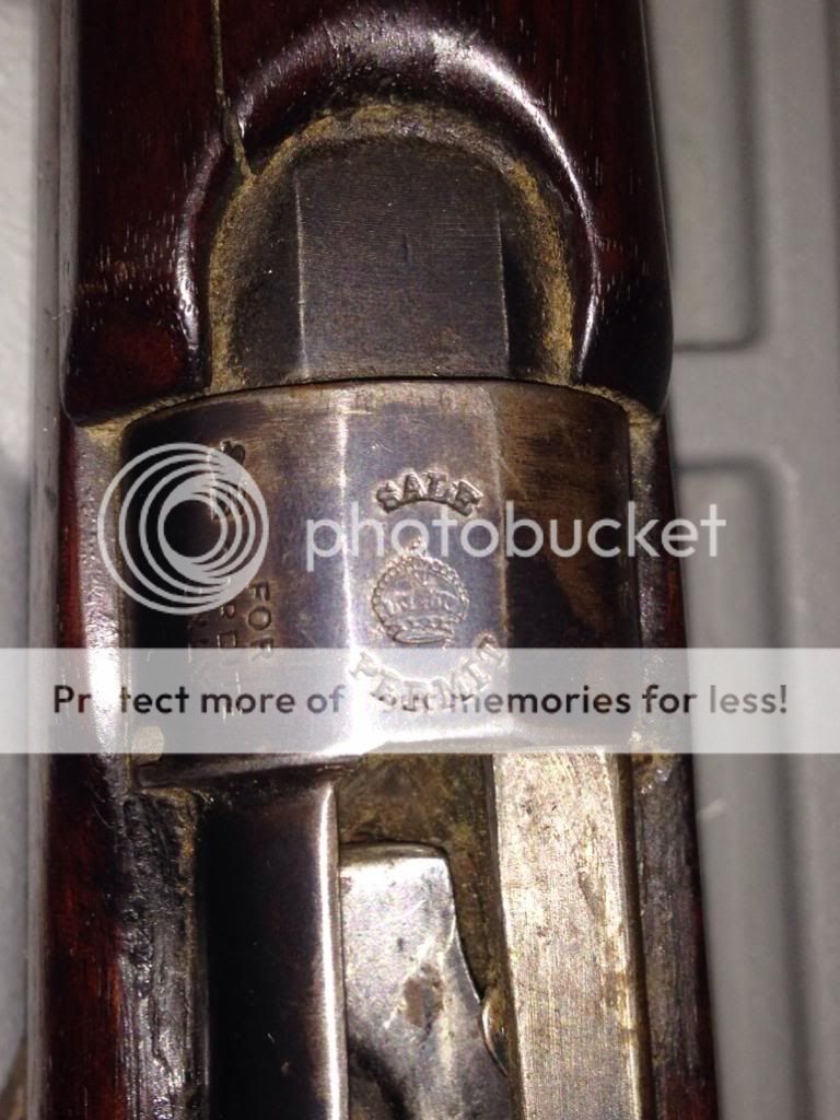

Does this stamp mean that the rifle was approved for export and sale?

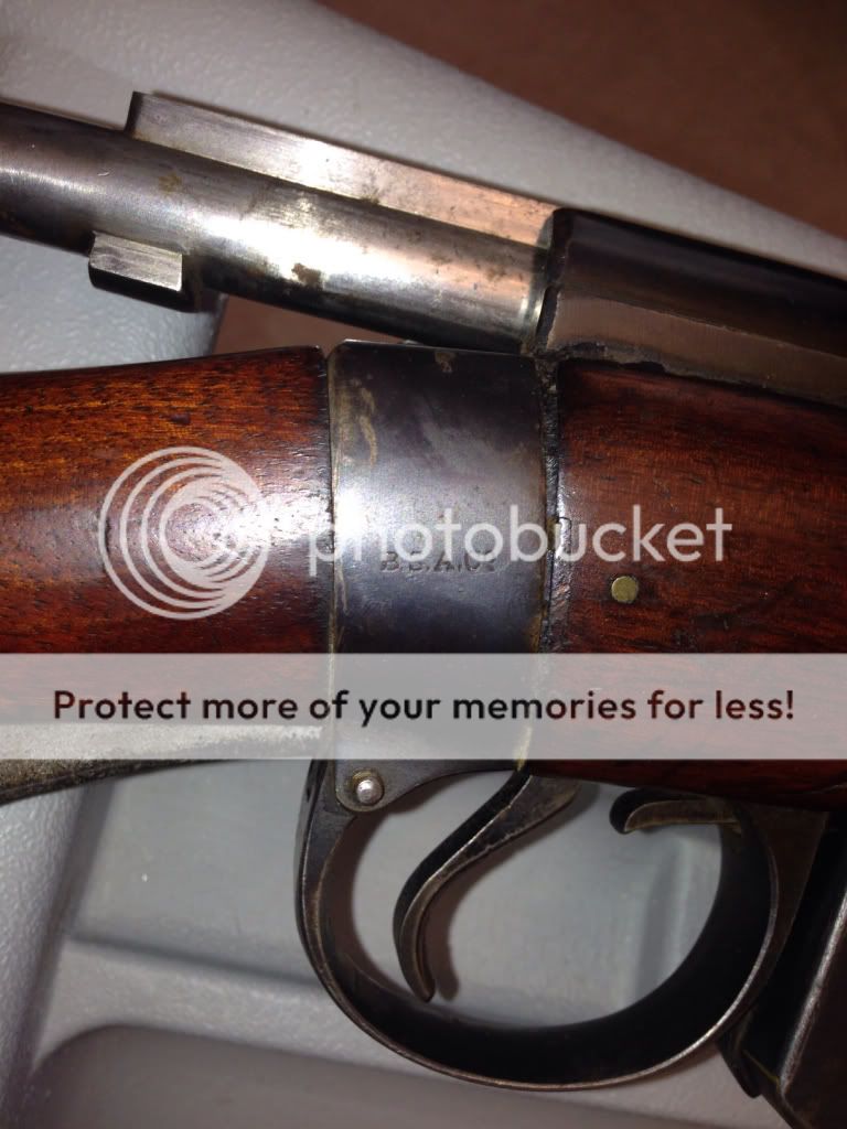

the rifle has a extra heavy band applied around the forearm
It was a target rifle. If you were to disassemble it, you would probably find some interesting bedding modifications.

Definitely a full Commercial rifle.
Definitely used for very serious target shooting; band proves that.
Love the "Sale Permit" marking: very distinctive.

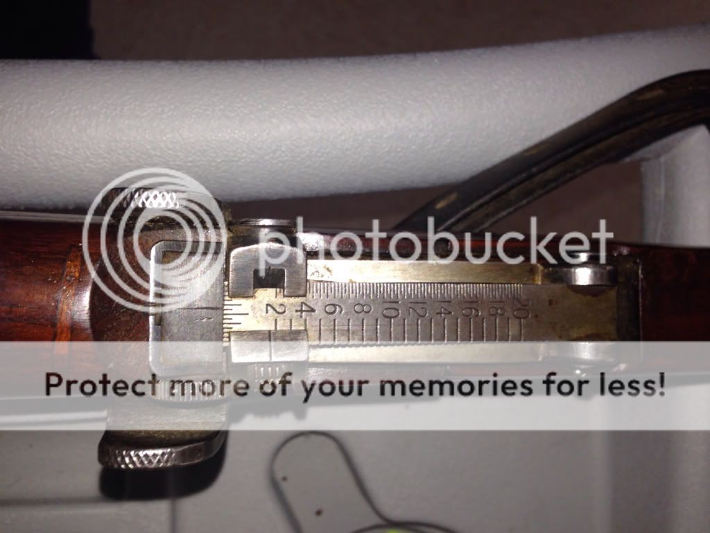

I note that it has the drift-adjustable rear sight. These disappeared from Army rifles during the Great War because they were slow to make, came back on Commercials between the Wars. That gives you more or less of a time period, anyway.

For cordite only?
How will this gun handle modern ammo?
It will handle modern ammo just fine. I believe the cordite stamp was used on early Smle's so that people wouldn't shoot the earlier black powder cartridges out of them.
