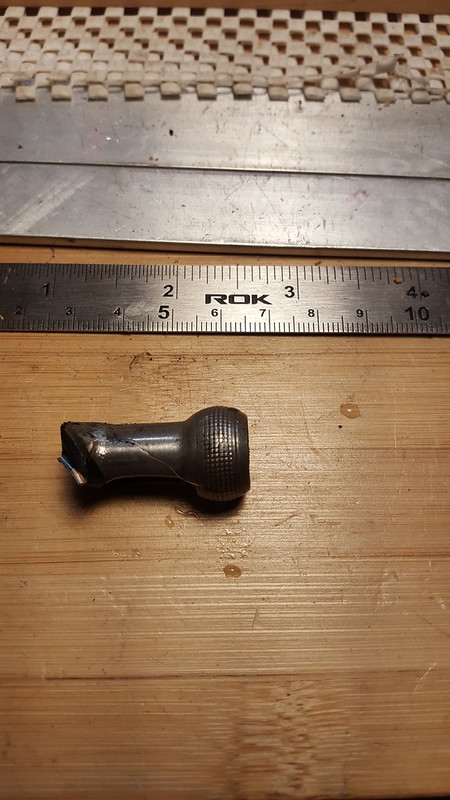

First I marked the bolt for cutting.
Then cut the extra bolt off leaving enough meat to shape for the welding.

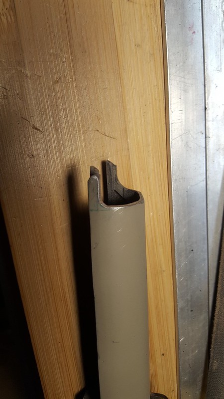

Another step will be to cut the receiver cover to allow full bolt travel.
Regardless whether you cut the existing bolt and weld it back on the left side or add another bolt on the left side like I did in this example, you will have to cut the receiver cover to allow full bolt travel. Start by drilling a pilot hole at the intersect point to maintain a radius corner. This is stronger than a sharp corner and will help to prevent over travel when cutting.

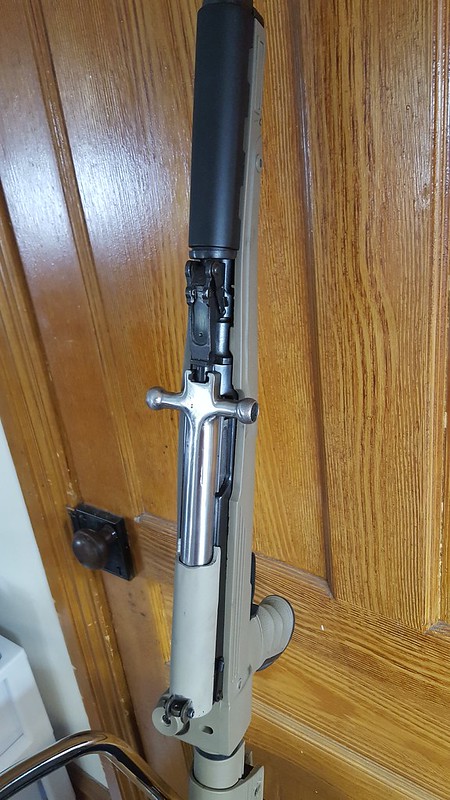

All welded and assembled. All works as it should and no issues of course. This was a simple fun project and one anyone can do at home.
The last person who welded the charging handle to the left side without drilling into the carrier, the handle fell off after shooting several rounds.
I would have done it a galil style.
Thanks for all the kind words and to answer a few questions. Yes I fired it off and no issues. It's a peep that I made last year on this one and is adjustable left to right. Fiber optics up front. Makes a very fast carbine.

Looks better using the original style bolt handle then home made. I'd probably remove the right side one at this point however as the double does look a bit odd.
The Galil style idea would be good, as it would be even more ambidextrous...could be fit to either side.
