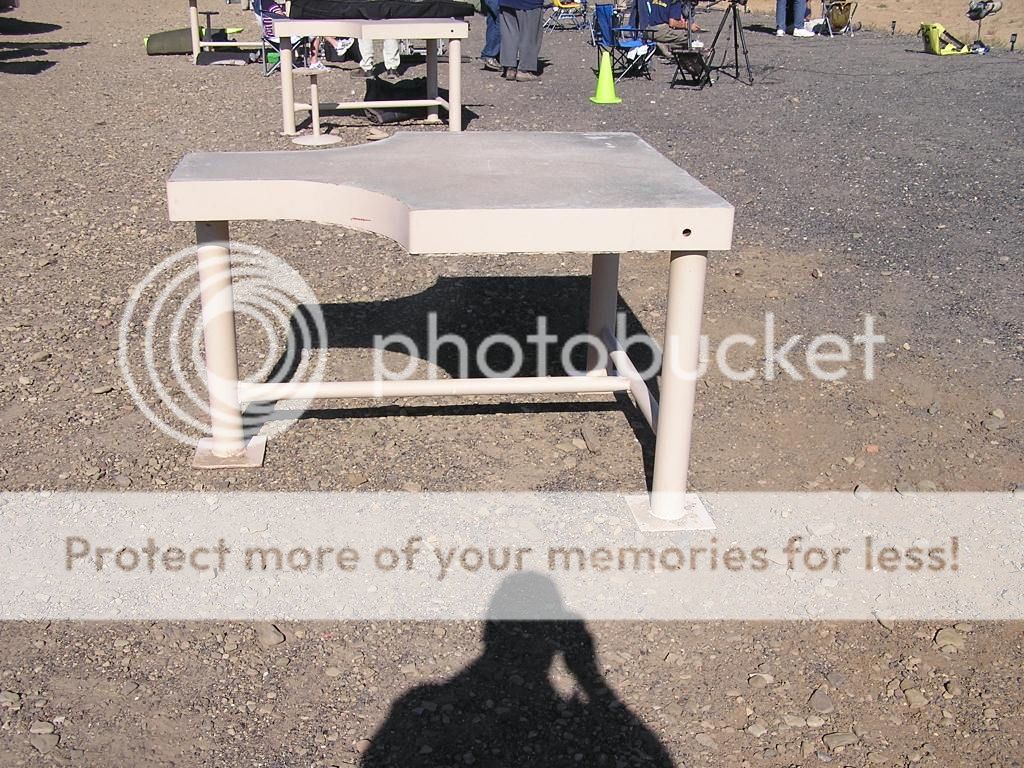

Are there specific dimensions of surface area and height for benchrest shooting and if so where can I find them? I have been asked to build some. The only ones I have seen were at Raton (pictured) at the 1000 yard range. The top was all cement. The one thing I did not have was a tape measure, I should have put something in the pic so I could scale but I was there to shoot prone and did not have time.
I have the steel posts, cross pipe, and re-bar. Just need dimensions.

Your best bet is to build a 4" reinforced slab on grade over 4 inches of compacted gravel (that'll minimize heave). Sink anchor bolts in the slab and fasten the bench pictured in the above post to it. You'll have a rock solid shooting rest.
If a slab base is not what you want to do, sinking your metal legs 4 ft into ground should give you sufficient penetration of the frost line. Fasten your concrete top to the legs. You could consider using a system of threaded anchor bolts in the bench with two nuts at each of the leg attachments to allow you to fine tune the bench height/level.

but before you jump in get a sheet of OSB or plywood and make a template of one of the patterns.
then flip the plywood over and make another pattern and place it on a talbe with the end sticking out so you can
EFFECTIVELY GET BEHIND THE GUN and place both shooting rear bags and front rest (or tripod) onto the template in order to judge the design chosen.
You may quickly see that getting your belly into the curvature of the design is the most effective. i am not good with words but once you see the limitations of the other designs you will quickly see how comfortable getting into place can be. Also if you place the other loading blocks ammo cases and stuff in the bench you then get a feel for thegood, bad and plain ugly in some designs. i will still try to get the measurements from someone this weekend. We tested 6 designs a few years back and we liked the curved sideplates with a longer back end. Some of the ones tested like in colorado at the firewalker are just downright wrong and do not function at all.
