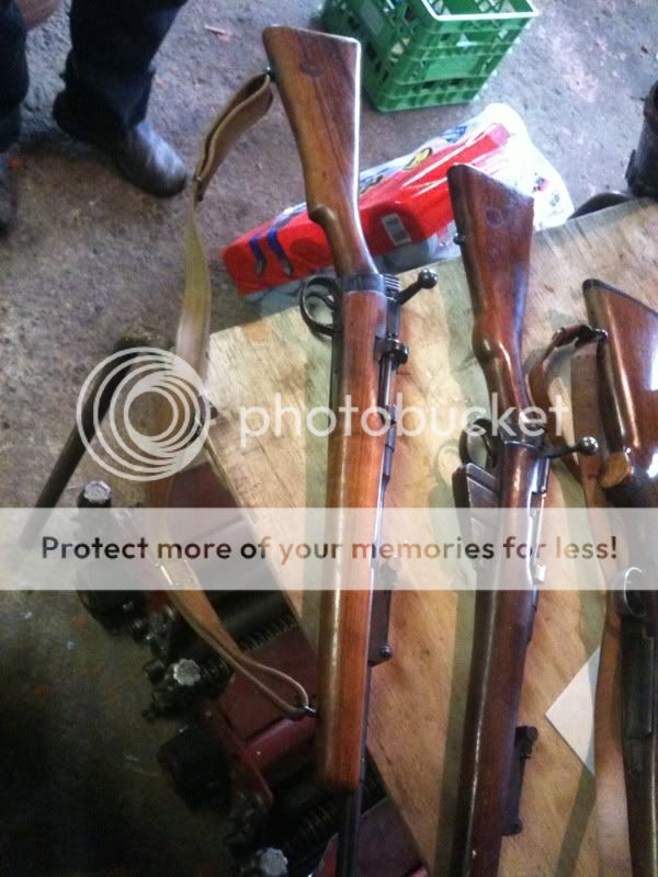

I've always wanted a full wood #1 mkIII but considering they sell for what they do, I though this might be an interesting route.
One of my employees has a sporterized one with the original uncut barrel and front sight, the middle one in this terrible pic.
What kind of financial mess would I be looking at? What should I offer him for the gun?
Where would I find replacement forestock wood and how much/little could it cost me? Original sling?

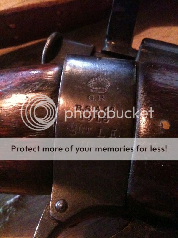

That one has the Magazine Cutoff, so it likely is an early one. What information is on the Butt Socket, just under the Bolt Handle? It should give you the actual YEAR the rifle was made, where it was made and the precise Mark (which will be III) with or without a Star (*). That much will tell you HOW it should be restored.
Does it have ANY of the Volley Sight parts remaining? Some do (plate in the fore-end), others do not.
There was a period (late 1915, early 1916) when the design was very much in transition due to Wartime shortage of rifles and the difficulty in making this particular rifle. Shortcuts were taken which later became standard: mods to the Rear Sight, removal of the Magazine Cutoff, removal of the Volley Sights, modifications to the Chamber and so forth.
It IS possible to restore one of these rifles, but YOU have to pick just how far you want it "correct"..... and for what period. A 1909 rifle still in use in 1918, for example, likely would have had the Cutoff removed already and the Volley Sight assembly removed apart from the Plate remaining in the fore-end.
It can be confoozin'.
Most of the parts you will need can be sourced here or at your local gun show. Correct sling is on the bottom rifle in your photo!

The pic I have of the buttsocket;
Soo... 1916.
