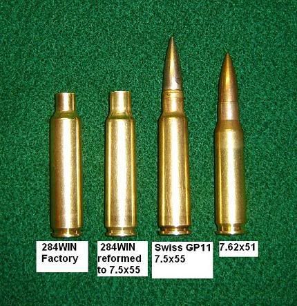

There are different variants of Swiss 7.5 rifle rounds
GP90, 1890, 7.5x53.5, 36000psi
GP90/03, 1903, 7.5x53.5, 36000psi
GP90/23, 1923 7.5x53.5, 38000psi
GP11, 1911, 7.5x55, 45550psi, with the first(?) VLD bullet.
