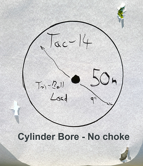

At 30 meters all three balls stayed within a 9” circle, however at 50 meters the group/pattern opened up to around a 11 to 13 inch group. And that is not good enough for hunting at that distance in my books. All three balls penetrated a ½ inch plywood board at 50 meters without any problem.

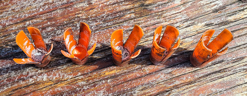

Recovered Wads:
50 meter group:
