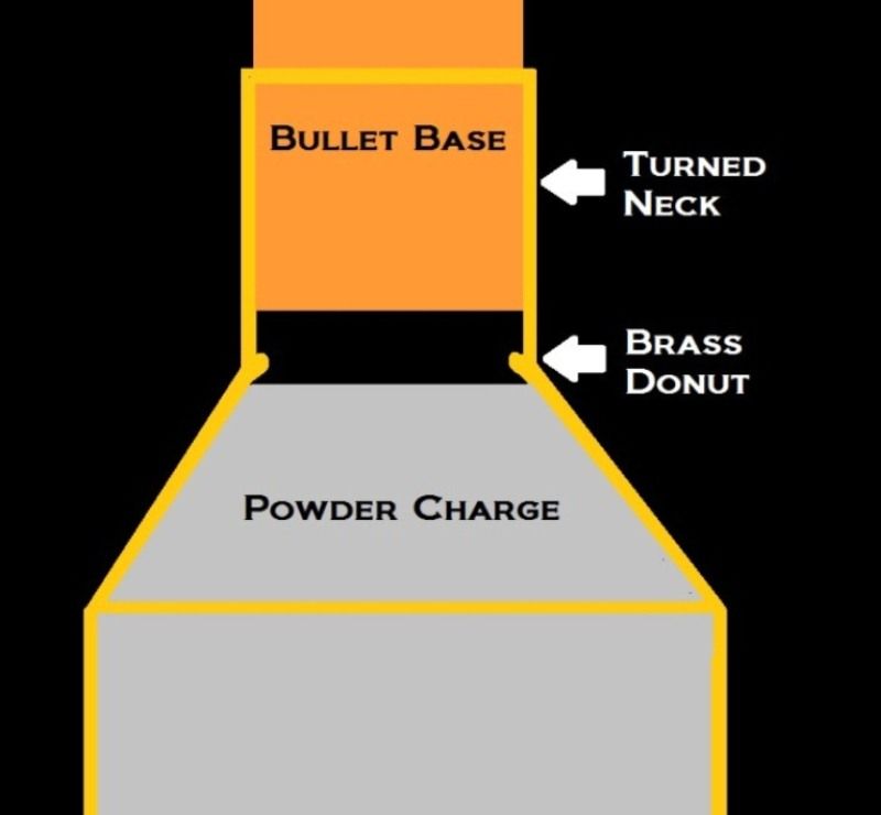

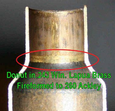

Jerry, please educate me...what do you mean by "seeing donuts"?
this is a thickening of the base of the case neck. You can form this when expanding a case ie 6.5-284 to 284, or 243 to 260... part of the shoulder now becomes part of the neck.
From firing... brass flows under pressure and builds up at the neck/shoulder junction.
From sizing... brass is push down to the base as it is squished in the sizing die. Bushing and reg neck or FL sizing dies will do this.
The affect is to cause a constriction in the case neck which can affect how the bullet is seated and released. At best, it can lead to irratic accuracy. At worst, it can elevate pressures to dangerous levels.
proper sizing and outside neck turn will keep this in check.

Thanks Ed...good diagrams here. Still learning and this helps.
Regards
Ronr
Jerry
Noted. Learned a bit more here as well. Thanks Jerry.

***edit...if I suspect donuts forming do inside reamers remove? I haven't noticed on PRVI or Lapua but the Federal stuff that I sectioned had some features starting like the photo's Ed posted. I chalked it up to Federal being soft but this has got me thinking a little bit. ***
