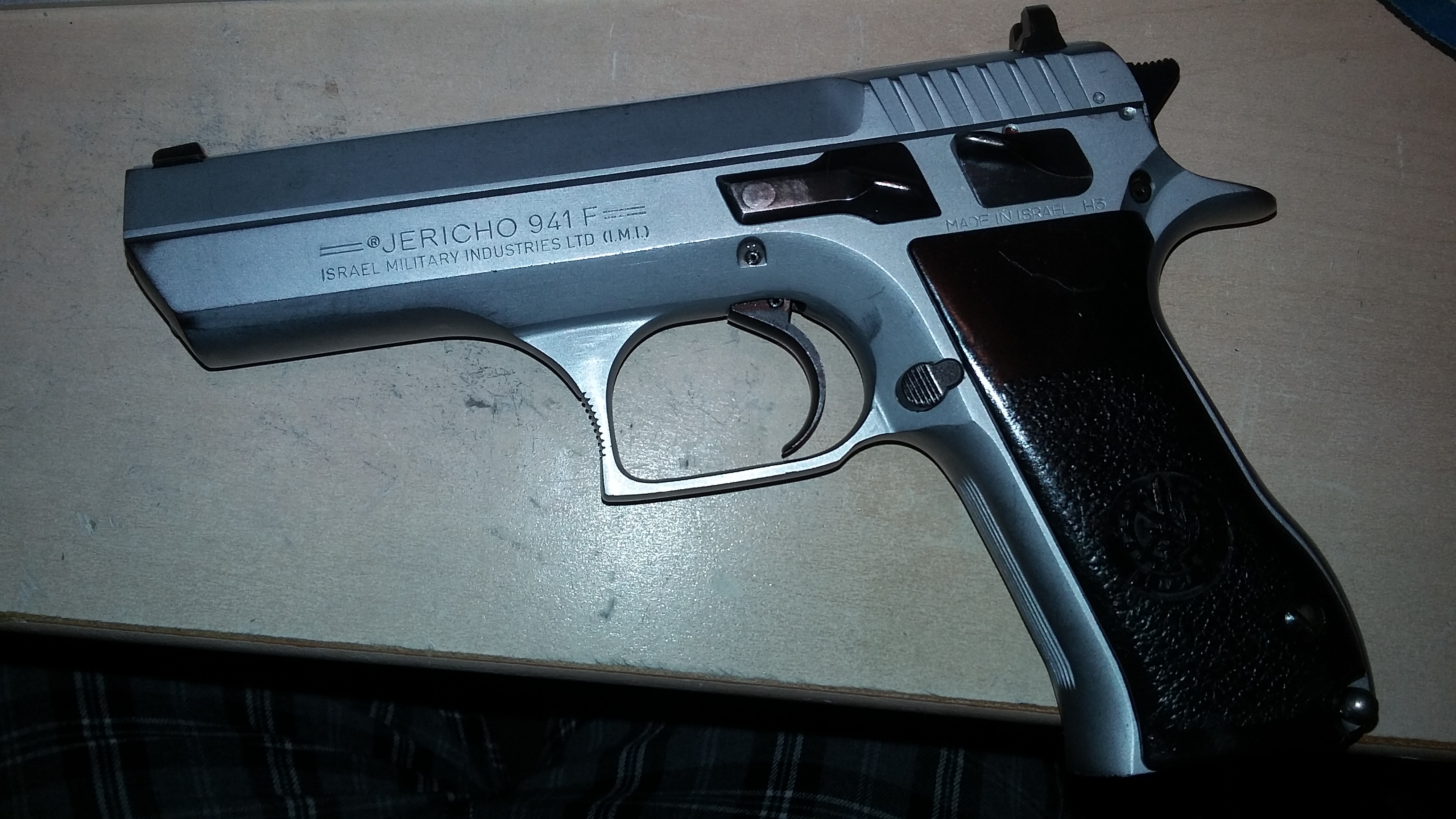

I recently purchased a Jericho 941F. One of the police trade ins that popped up last week. I am now wanting to convert it to DA/SA. it is currently SA only. meaning you have to draw the hammer back. Has anyone successfully done this? I am assuming its not a big deal as these were customized for the police department as to force them to carry with an empty chamber and include racking the slide as part of their presentation when escalating use of force. anyway. where to begin? Any help would be helpful
Thanks!
Here is a pic for those who are curious.

You are a gentleman and a scholar. I have a sneaking suspicion it is going to need a trigger as well to convert. Because the trigger currently installed does not have the ability to travel forward enough to be in the double action position. It remains back in the cocked position all the time. Its the trigger itself. I noticed this today when cleaning it. Look at the front where it meets the frame. Either way I hope yours turns out excellent as well and that we figure this out. Mine did not come with the black plastic thing, I assume this was to again help protect against ND by closing the extra space in the trigger guard. It did however come with a large amount of what appeared to be tan colored dust absolutely caked into all the nooks and grooves. Yours will probably be the same. I disassembled mine and cleaned it with a stiff toothbrush in a sink full of hot water and Palmolive. Then dried it with the wife's hair drier gave it a nice CLP soaking and a wipe down. Very impressed overall with the condition.
You are a gentleman and a scholar. I have a sneaking suspicion it is going to need a trigger as well to convert. Because the trigger currently installed does not have the ability to travel forward enough to be in the double action position. It remains back in the cocked position all the time. Its the trigger itself. I noticed this today when cleaning it. Look at the front where it meets the frame. Either way I hope yours turns out excellent as well and that we figure this out. Mine did not come with the black plastic thing, I assume this was to again help protect against ND by closing the extra space in the trigger guard. It did however come with a large amount of what appeared to be tan colored dust absolutely caked into all the nooks and grooves. Yours will probably be the same. I disassembled mine and cleaned it in a sink full of hot water and Palmolive. Then gave it a nice CLP soaking and a wipe down. Very impressed overall with the condition.

The trigger that comes on these trade-ins is specially designed for the SAO pistol, It has extra material on the front so it will not allow the trigger to move forward like a DA trigger will on reset. So if you want a DA/SA I will have to send you a trigger as well with the hammer disconector.
