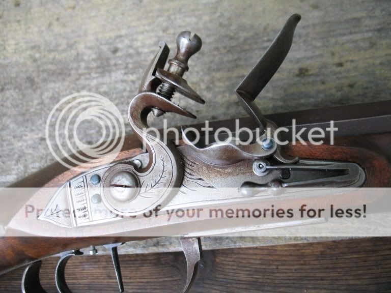

Here is lock I did, not a great pic, but you get the idea
Another Lock...same technique, not mine though
