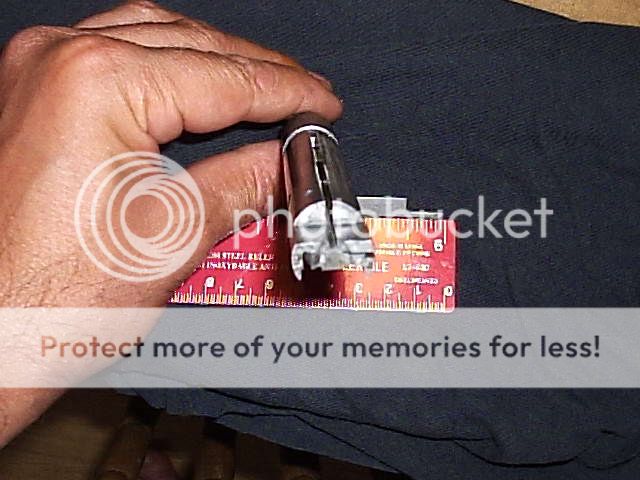

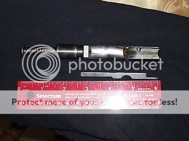

Ya the pics in the EE are mine.I took the Cooey bolts as part of a trade. Didn't want to but you know how it goes. I had 3 of them but there are 2 different styles. I just wondered if they would both work in any gun or they are specific to older or newer models ?
Here's a copy of the picture. Bolts # 5,6 and 7 are the ones I have. Here are the 2 different bolts closer.The firing pins and the pull handle holes are even in a different locations.
Looking at your pics...I'm guessing (under line and bold guess) you have 2 64 bolts of different eras...
One of yours is identical to mine. (screwed in leaf-spring extractor)
The other is newer, with roll pin retained extractor. There's also a relief cut out of the bottom of the firing pin as pictured in the Savage diagram posted back on page one.

The bolt handle not being in the same place helps confirm this too...my older 64 has a detent/relief that the charging get pressed into for "safe"...newer ones don't have that, but a safety incorporated into the trigger.

I'm not sure honestly...I sold off my newer Lakfield n' Savages so I can't cross refrence...It would depend on just how much different the charging handle's placement is. Even then, the rifle might function (with no safety on an oldie)...If you'll measure the distances of both of yours' from bolt face to charging handle you'll be able to tell. (I'll measure distance from "closed" bolt to the "safe" position)
On bolts in general...slapping a bolt in, and having it fit n' function (safely) is a rare thing. There are a few smiths n' parts vendors that won't sell just a bolt to a regular Joe like myself because of this...On the 64, it would be important to see if the cut-out in the bolt's top matched well with the barrel (on a 64 part of the barrel fits that cut-out). Same with the firing pin...
As often as folks type "check the headspace" in these forums, a bolt swap in any rifle should take this into consideration.
