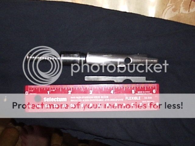

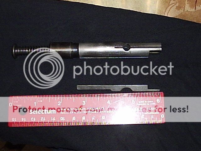

Anyone else have a bolt handle u can see through the side of the bolt when disasembled or is it just worn through? Functions perfect...seems like very thin machining or just worn through
There's some insight...The hole in the bolt where the charger handle fits should be all the way through.
Rt side of bolt
Lt side of bolt (with ejector groove)
The rounded cut in the firing pin allows bolt handle to be installed. Once fully assembled the firing pin retains the charging handle.
Its where the handle goes in the hole u can see part of the handle im thinkin its worn through now top pic lower of bolt handle hole were narrow u can see the side of handle in the hole i hope this makes sense i need to learn how to do pics on here thx
