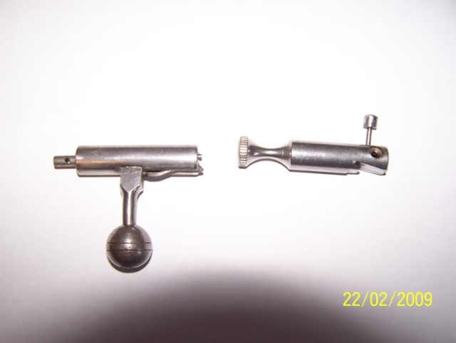

I've got a cooey 75 thats seen better days, i've been putting some elbow grease into cleaning it, and am onto the bolt. How do you pull these puppies apart? I've noticed a notched collar on the inside of the bolt, but short of getting a little tool rigged up, i cant seem to find any other way to pull it apart.
Any Idea's?

I have same issue with disassembly. How this rifle is so common but their isn't any video to guide users?

The bolts are not designed to be readily field stripped. The cocking piece can be removed from the striker shaft by driving out the crosspin (which is also the guide lug).
A tool has to be made to unscrew the collar that retains the striker rod and mainspring.
The extractor is removed by pushing the hook away from the bolt face and prying the extractor forward. The extractor has a protruding lug that secures it to the bolt.
IT IS REALLY EASY TO BREAK THE EXTRACTOR WHEN ATTMPTING TO REMOVE IT.
The firing pin is retained by a pin under the extractor.
The extractor is replaced by pushing it back into place, prying it outward so the retaining lug clears and snaps into place.
IT IS EASY TO BREAK AN EXTRACTOR WHEN DOING THIS.
It is best not to disassemble these bolts unless you absolutely have to.
The bolt handle is also the locking lug. These are individually fitted to rifles. A used bolt may or may not safely fit another rifle.
Earlier bolt handles were dovetailed into the bolt body and brazed in place. Later ones (Winchester Cooey) have handles that have a peg which engages a socket in the bolt body and are induction brazed. The earlier style is stronger - I seen later ones broken off.
