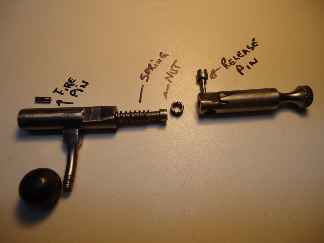

ok here we go ..send me an addressed envelope with a stamp .i will return it to you with a fire pin [no charge]
" if I remove the ejector, then the pin which retains the firing pin will be visible and easy to punch out and the firing pin will fall out the front face of the bolt?"
if u remove the extractor the pin which retains the firing pin will NOT be visible because there is a small hidden pin that holds the fir pin in place .when u receive my fire pin u will see the slot on the fire pin and it will give u an idea where the hidden pin is located.
