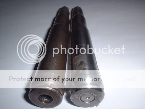

Cooey also made these items for the Canadian Army. They are the subcaliber adapters for the .55 Boyes anti-tank rifle. The hole down the center is rifled to accept a .22 cal round, and you have to place the little adapter (shown still in the right one) to have the centerfire Boyes act on the rimfire .22 cal round. The base of the round is marked with the C/I\ along with the HWC (HW Cooey) logo.
